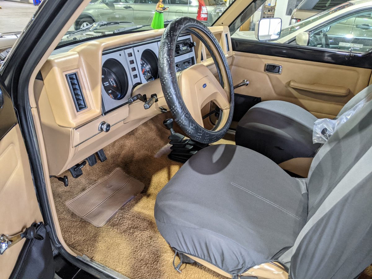

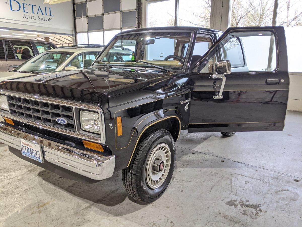

Thanks for all the feedback guys... I feel so lost lol, don't know where to start. Talked to a couple custom shops, to do what I want to my B2, $10k+. So got to do it myself....
I have some happy news though - just it get detailed :) :) :) (attached).
