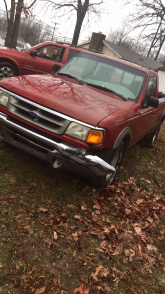

My truck I purchased as a wrecked clean title truck.. Later to find out it rear ended a parked car at 50 mph.. Bent the front drivers side axle beam, bumper, radius arm and bracket, and dented the fender. Frame horns never got harmed. Air bags never deployed. I'd replace the bumper on yours. It's not hard. 4 18mm bolts. 3/4 on older ones.
I fixed this one up for a couple hundred bucks. Damage was probably way worse than yours.

Actually they are 18 on my 97, and 21mm on the 94 that I removed the bumper from. Your bumper looked worse than mine. Those frame rails are pretty sturdy, so if you didn't blow the airbags, you are probably all right
