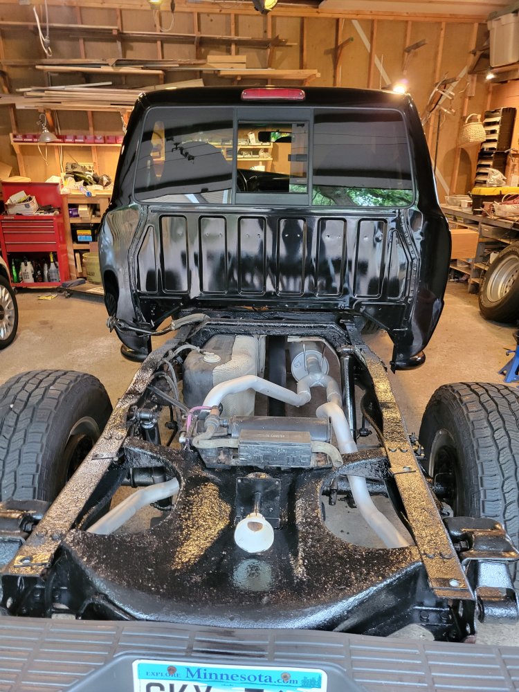

There is an old saying which goes, "neither down nor feathers." Bare metal is not good but neither is too much rust. I blasted the frame in a fast pass, removing encrusted dirt, the crusty layers and scales of rust which had not adhered tightly to the metal. Hopefully I have not erred to one side or the other.
POR-15 makes a surface prep product which contains an acid and a zinc treatment that promotes adhesion. The photo shows how it works. It's etched some of the rust away, but most is still there. The next step is the paint itself.
Also I blasted the exhaust system clean. It's going to get a coat of high temperature ceramic paint. I chose Rustoleum. Eastwood makes a product too. I'm not sure if there are any products which will be durable.

I spent today crawling underneath and brushing POR-15 on to the underside, including the front half. the frame under the cab. I found it in pretty good condition. It went rather fast so I doubled back and applied a second coat. Tomorrow I will tackle the bed.

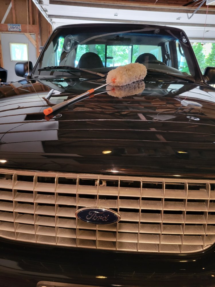

Also cover the cab with plastic drop to keep the dust off of the finish. Some will be there anyway. Dust it with no downward pressure. After all, abrasive materials may potentially scratch minor scratches or swirl marks in the clear coat. I use a big duster to clean my truck anyway.
If you wash the truck, use a pressure sprayer if you can. I recommend throwing the plastic away so you don't breathe the dust on it when you unfold it later on.

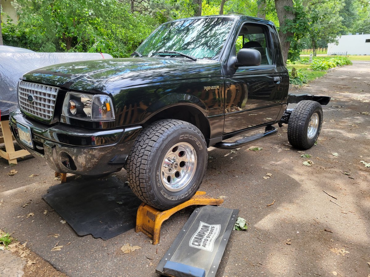

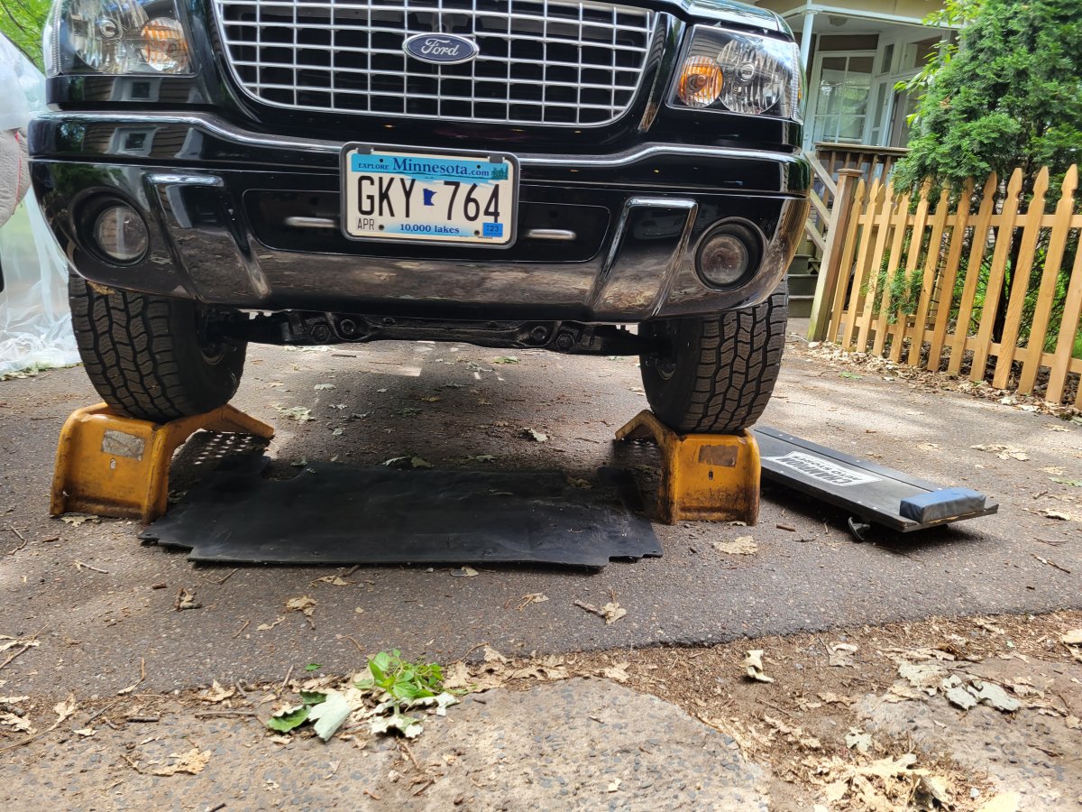

i got those same ramps at a garage sale years ago. ramps are always useful. and they stack on top of each other to take less space.
i like garage sale tools. especially ramps, cherry pickers, engine stand because people usually use them once and than sell them because they are taking to much space.
