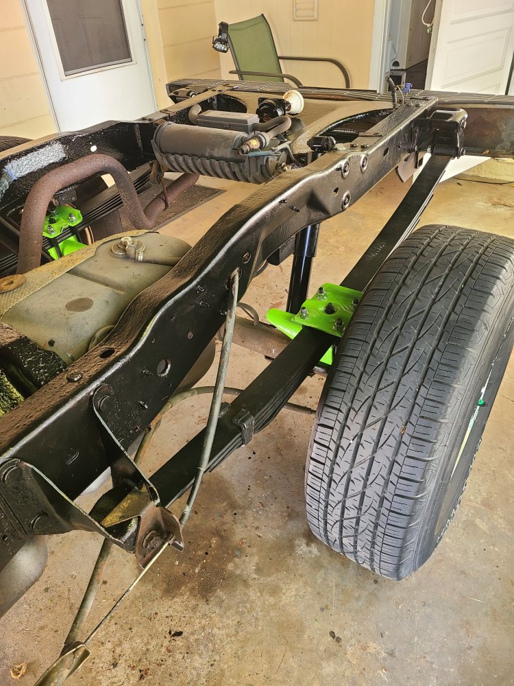

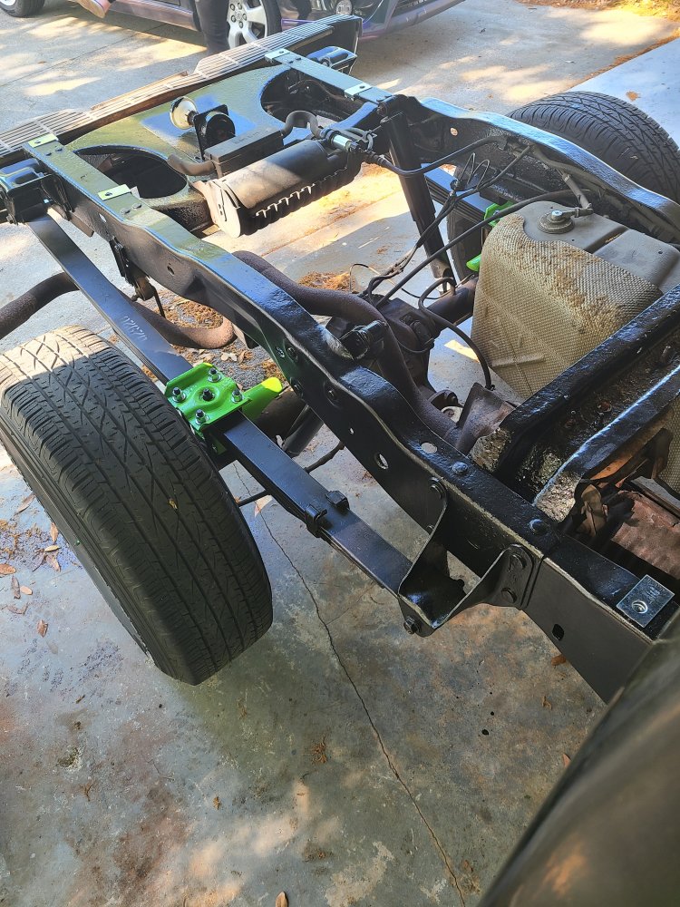

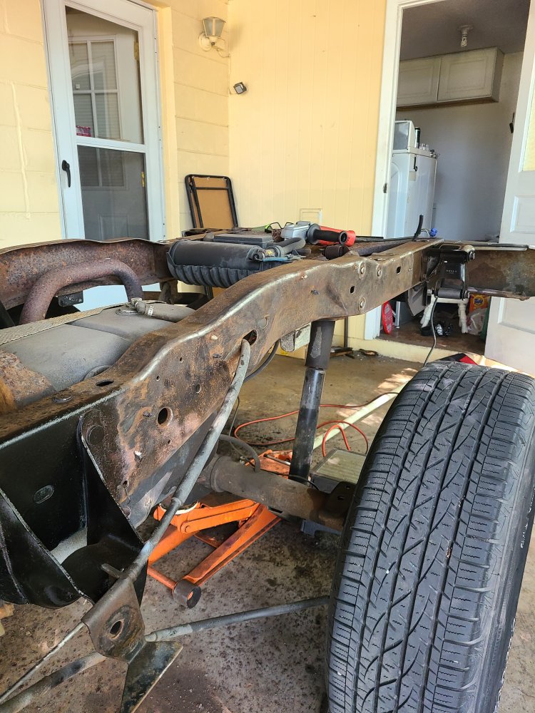

As for back to the OP. I'd go through and repaint everything I could with the bed off, check all the wiring, pull the fuel pump/sending unit and make sure the pickup screen/tube are clean and not cracked, heard the pickup tubes can fail on them over time. Maybe do some rust proofing of the frame and underside of the bed. Lubricate the spare tire carrier assembly too.

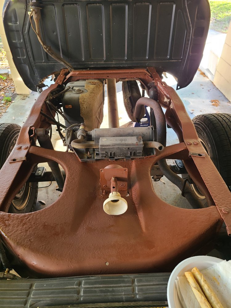

Take a picture of the back of the cab. Please.
Just did this with my 02. Inspect your front to rear brake line ( I had to replace). Hoses on top of the fuel tank, evap solenoid
