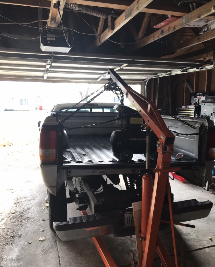

my crane folds and I didn’t have any issues. Granted I didn’t actually move the bed with the lift, just raised it and drove truck out from underneath then when I was done (fuel pump replacement) I backed the truck back under.
I did have a small compressor in the back to help balance the bed.
My cherry picker is similar to this, but orange (harbor freight)
Ok, so I just needed an air compressor (or couple bags of sand) at end of box to balance. :) 'cause that engine crane is more/less exactly what I have. 3.0 and manual was no issue for it (other than garage door got in the way).

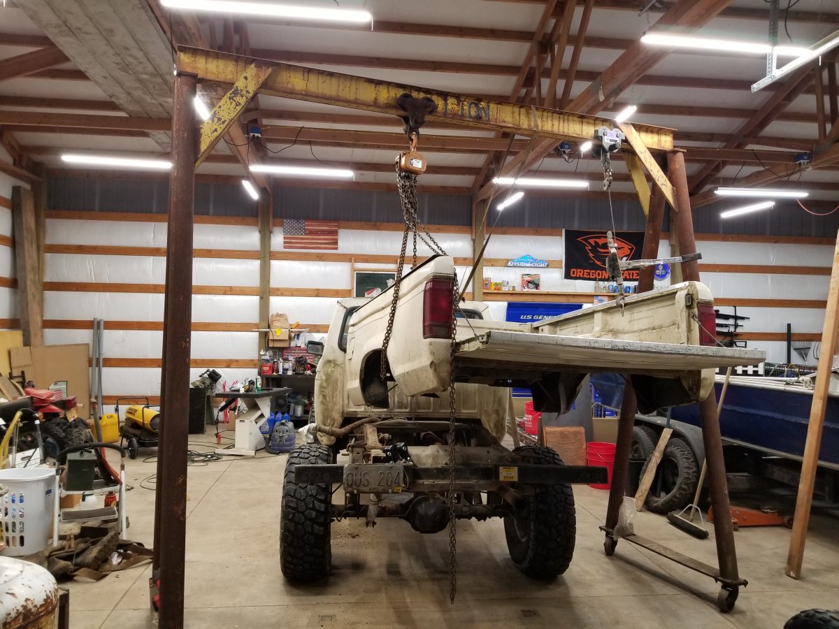

Last time I had the bed off my '90 I used my 10' tall and wide A frame with a comealong and a chain hoist from the bed rails though, I didn't get the balance right so added a ratchet strap...

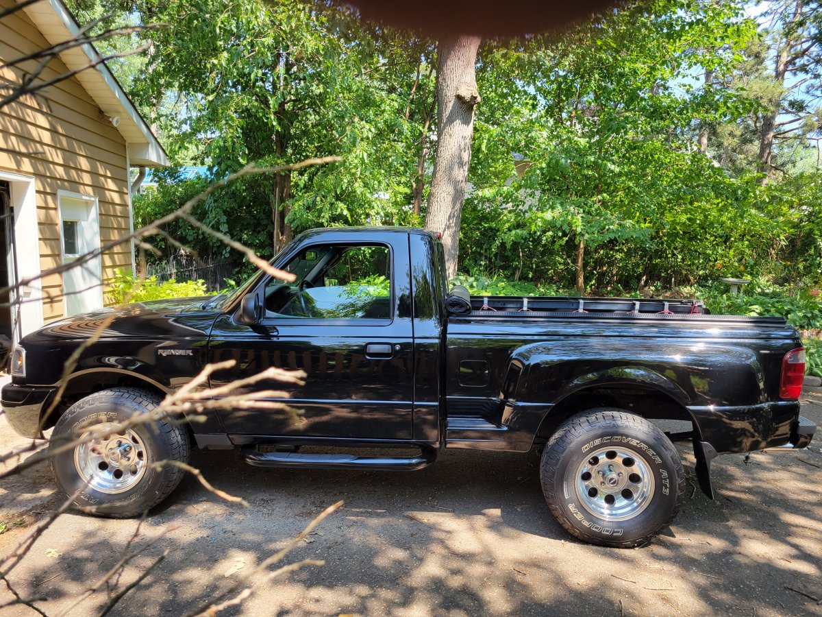

I've been busy since the last post, removing the two inch lift blocks and replacing them with one. I lowered the front end by about 1/2. The change might be modest but it saved me from buying new shocks, keys, and ancillaries. It also saved the cost of a front end alignment/camber adjustment.
My buddies came over again to put the bed back on. It was no problem to line it up and drop those bolts back in.

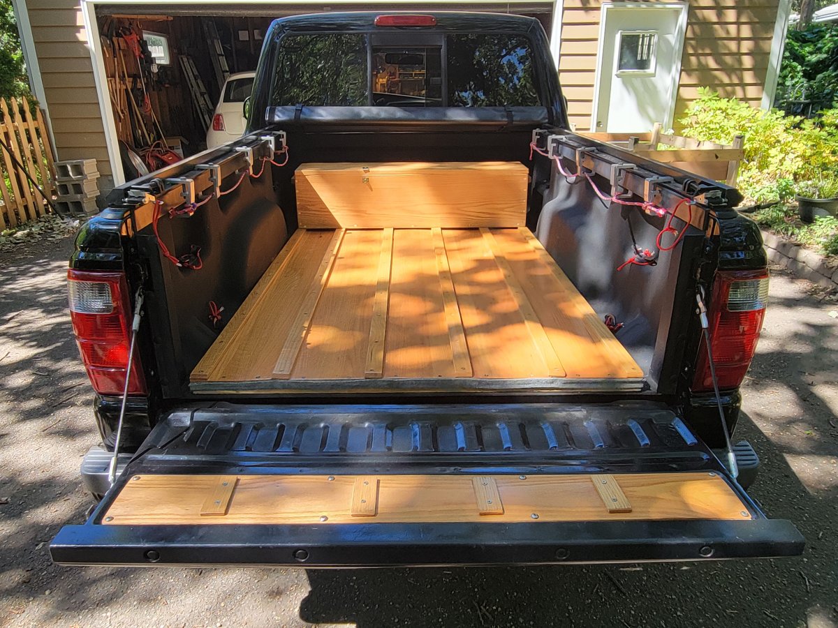

Instead of buying a bedliner I had made my own from red oak last year. This time I put a third coat of polyurethane on it in order to reduce UV damage. Red oak is a beautiful hardwood, but tends to absorb water. Poly is a necessity.
It's been a couple weeks, but this project actually took about 18 hours. No one really wants to do this job, but it is necessary especially on Ford frames. The factory paint was never very durable. It's entirely gone after 20 years here up north. A frequent visitor to the U-Pull yard, I've seen many Rangers of the same age looking pretty bad, even worse.
Now I'm driving an old truck that looks brand new.
People like the old school bedliner too.
that wood bed liner looks nice. i always liked how truck beds had wooden floors back in the old days. that always made the truck look higher end to me.
That wooden bed is a subtle nod to a grand old tradition that goes back a hundred years.
