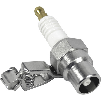

I use one of these tester... most electronic ignition should jump this gap. Most times you don't even have to see it. You can hear it.

Thanks for the advice on the spark tester
