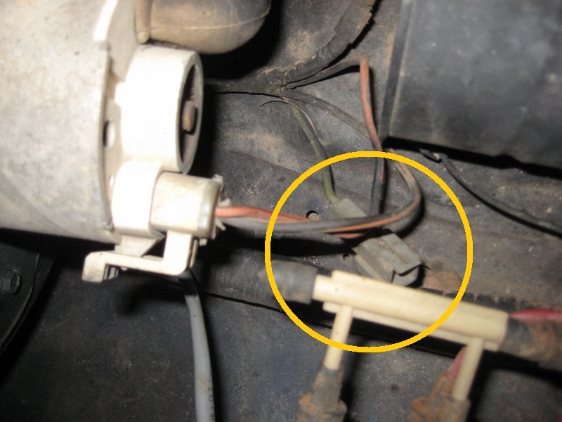

I got the carb rebuilt, put back on and the engine runs great. However, I am still at a loss about this automatic choke. I cannot tell if it's working or not. I know that it's not getting any power. I ran a multimeter to the choke wire and it got nothing. So I traced the wire back to the red connecter hookup (see picture 1) and it was unplugged. Makes sense that it wouldn't be working if it's not getting any juice!

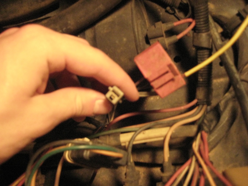

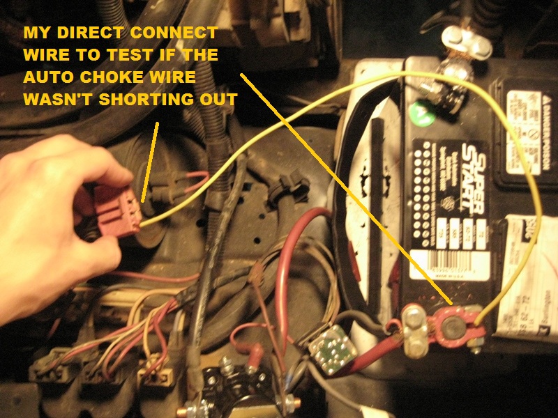

So, to make sure that I didn't have a short in the wire, I ran a direct-connect from the part of the connector where the choke wire hooked up to the battery and then tested the choke wire (see picture 2). I got 12 volts. So I know nothing is wrong with the wire, I just gotta hook it up somewhere.

1. Where does this red hookup go to? I cant find any place where it hooks up to at. (pic 1)

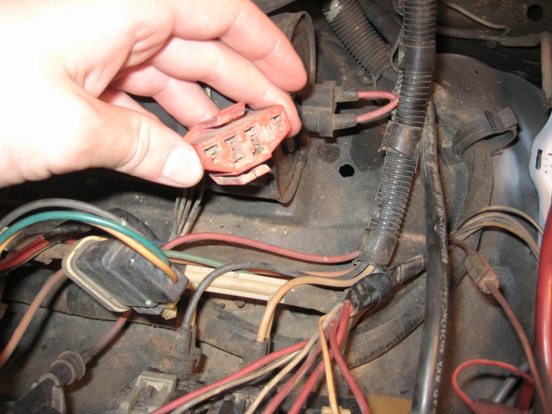

4. where does this hookup go? (pic 3)
5. where does this other hookup go? (pic 4) [this and the other don't plug together. I tried :)]

***Every picture is of something that is on the passenger side of the truck, and is right near the starter solenoid. I know that taking pictures of random hookups and wires can be hard to figure out what they go to, so that's where they're located if that helps out at all.***

Pic 1 is your test connector for pulling codes. there should be a grey/ wire in the harness over by the choke thermostat that is the power to the choke you should get a pulsing voltage to it after the engine is started and run for a bit. The initial adjustment for the fast idle is set the cam on the v notch for the high speed adjusting screw it is the on underneath and pointing back toward the firewall. turn that screw out until you get around 1100 rpm. Let me see if I can find the carb setting instructions that will show you pics. When the engine is cold the choke should slam shut when you push half way down on the skinny pedal. After you start it the pulloff should open the butterfly about 3/16 to 1/4 an inch and the high idle screw on the v of the cam under the choke. If you are running the feedback carb do not hook the choke thermostat to 12 volts or you will need a new one. The choke relay is controlled by the computer and gives the choke a pulsing voltage shortly after starting. That is the relay next to your battery there make sure the connections are all good and your a pulse out of the grey/wht wire. It is kinna a crap shoot on adjusting the choke thermostat I make it close the choke all the way first then start it up just make sure all the sensors are plugged in when you start or you will need to reset the computer by disconnecting the battery for 1/2 an hour. I just set the air filter housing to the side with the IAT sensor still plugged in. Once you confirm there is power to the choke plug it in and let it fully open while the engine is running. You must make sure the choke fully opens.
