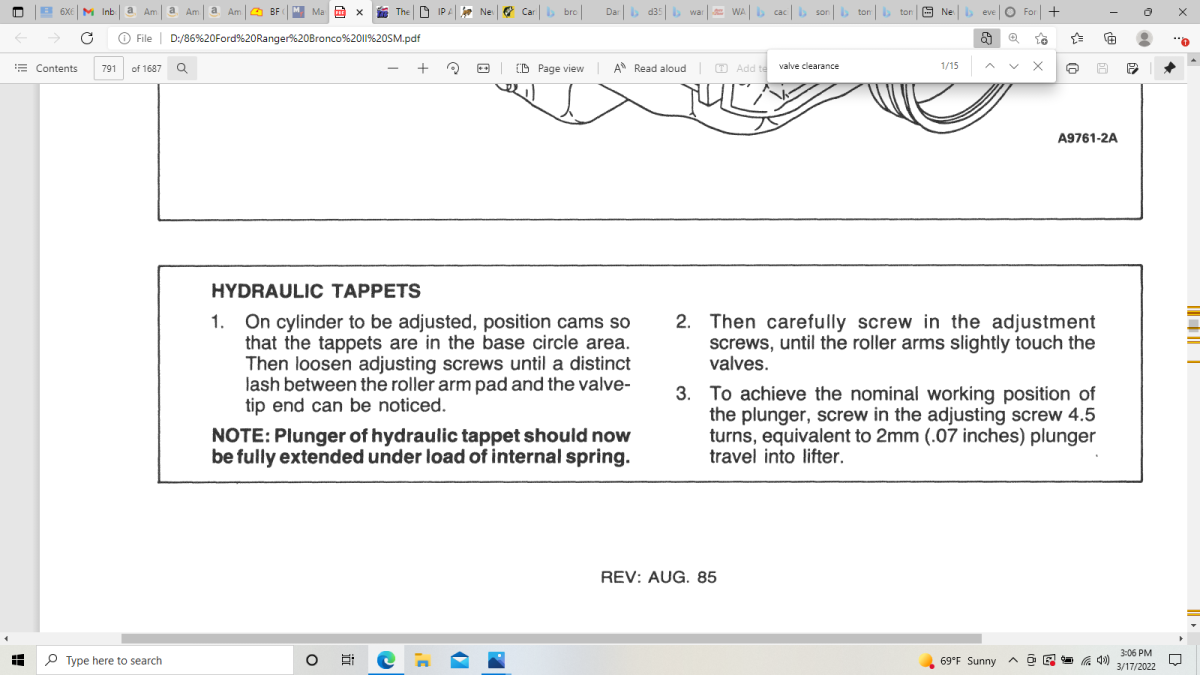

that posted... 4.5 turns seems a bit much honestly.
The 1 1/2 turns was what I always did on a small block chevy. With engine running back off adjuster until you hear the rocker clatter. Tighten until you hear clatter stop... then continue to turn 1 1/2 turns to set the preload. That was with a new cam/lifters. Used cam and lifters was only 1 turn.
