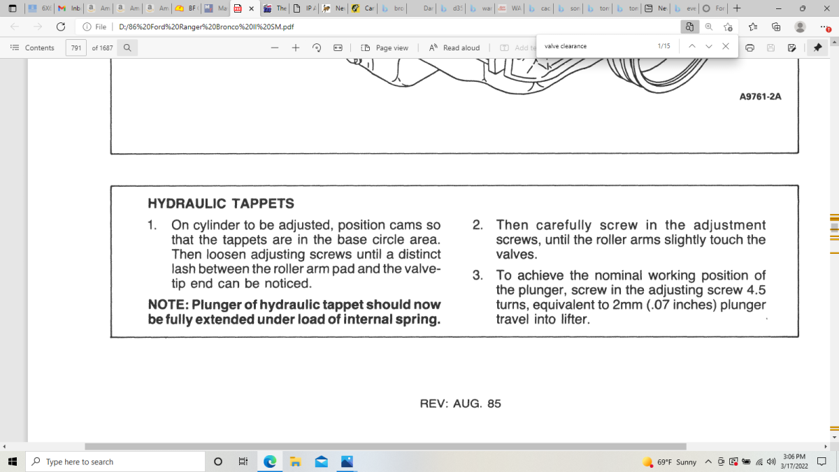

how many turns of preload on 2.9 v6 lifters bro?
This is directly from my factory service manual for 1986...
