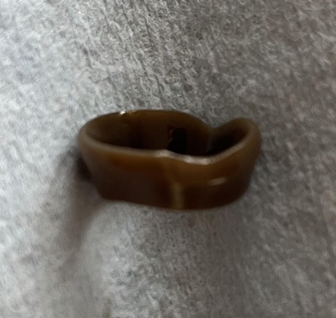

When you describe your 35k rebuild as clattering, do you mean top end noise? If so, pop the valve covers, remove the rocker arm assemblies, thoroughly disassemble, clean and inspect all components. If serviceable:
1) All the oiling orifices can be opened 1 machinist drill bit size from stock
2) deburr all rockers, pedestals and shafts
3) chamfer all 90° edges, blend out
There are other ways to.imptove this non-adjustable valve train, if desired.
@avid
Yes I think it's just standard valvetrain clattering, which from what I've read is typically bad on 4.0s. It's a "ticking" sound. But to be honest the Mazda engine with the cracked heads sounded tighter than the rebuilt Ranger engine ever did. (The rebuilt Ranger longblock was from O'Reilly's and think it was PowerTorque Brand or something like that).

30k miles is where I was taught to adjust the valvetrain. Since these are non-adjustable and it's making noise, it would be prudent to perform and thorough clean/inspection.
@avid
Thanks for the response, Gaz. Ok, I will do it and update.
@avid
Welp, the driver's side looked good. Passenger side looked ok but one pushrod on cylinder 1 was a bit flat. I looked in at the lifter and the cap was coming off. The other cylinder 1 lifter was also losing it's cap.
I didn't dig the other one out as I'll need to remove the lower intake at a minimum anyway.
Thoughts?
The 4.0 is a bit different than most OHV engines in that the pushrods are solid and don't send oil through them to the rockers. The rockers are oiled by separate galleries from the lifters. The plastic cup is there to retain a bit of oil to keep the bottom of the pushrod lubed.
Usually the wear happens on the top of the pushrod at the rocker, but since lifters are available and it's a roller setup I'd probably replace them.
