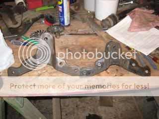

I finished stripping the '87 stx. Got it down to a bare frame. Removed drop brackets, rear shock brackets, sway bar brackets, axles, everything I could think of that I may need someday. I've also been stripping all my junk rangers and other trucks, going to the scrappers so I can get money for the race truck, work is a little slow, [and I'm not much quicker].
Well I decided I needed a better way of removing rust from these brackets off the '87 stx

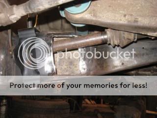

I also had a problem with the drive axle hitting the top and bottom rad arm bolt, so I replaced the top one with a d-28 [edit; that's a d-44 flipped, not d-28 RE EDIT; this bolt DOESN'T work, the threads on the smaller shank are slightly different, maybe from metric to standard, don't know where the d-44 TTB came from.] bolt flipped upside down, and cut the bottom bolt 3/8" shorter.
alwaysFlOoReD's race truck
Problem solved, except for now the drive axle was hitting the beam window top when passenger side beam down and drivers side beam up, and hitting the beam window bottom when articulated opposite.Cut lines penciled in;
The cut;
Axle clearances after heating red hot and forming the metal to approximate the original opening; hammered down on the right and out on the left

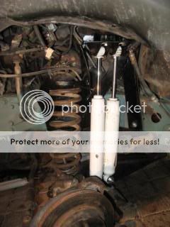

I bought and installed these shock mounts;
There's about 3/8" clearance between the shocks. I cut the old upper shock mount off the coil bucket and built a upper shock mount from material that I had on hand [from dumpster diving]. I'll be using the rad arm mounts from f-150's bolted to the top plate I built. There IS a gusset on top, hard to see. I may add more after drilling mount holes.
I'll see how well this stands up to the race cause I don't think I'll have time to test it before hand. I spent about 8 - 10 hours doing the drivers side, mainly cut and fit, check it, re-do it, repeat as needed. Repeated a LOT.

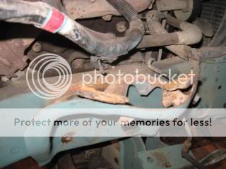

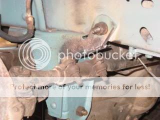

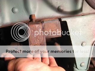

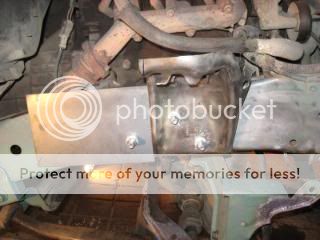

It seems like the title says; I busted a brake line and the frame behind the passenger coil bucket is very, very thin from rust.
I buttoned up the drivers side except for the brake line;

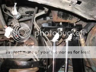

Upper shock mounting using f-150 rad arm lower shock brackets;
Started on the passenger side and realized I needed to take off the bump stop. Things like this are bound to happen when you've never done this before, I should have taken the bump stop off when I switched the drop bracket. Ohh, well,shoulda, coulda, woulda if I'da thought. So I removed the bracket and got the bump stop off. Proceeded to grind the rivets off and then pulled the coil bucket loose and found this; 1/4" thick rust that was behind the bucket
The two round holes don't belong, I put them there with a punch and hammer trying to clean off what I thought was surface rust.
I think if I incorporate a 1/8" plate bolted to the good part of the frame and welded to the coil bucket/shock mount I'll be o.k. I took a close look behind the frame and the engine cross member is right there so I think there'll be enough strength. Eventually I'll be building an engine cage and will plan to strengthen this area at that time.

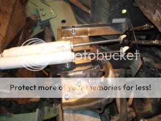

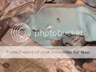

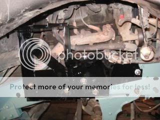

I've been working on the passenger side coil bucket, this is with the shock mount cut off;
Additional plate to strengthen rotten frame;
metal risers for top shock mount;
front view;
back view;
testing shock fitment;
Plate added to frontward of coil for extra strength, viewed from back;
Top plate and plate stiffeners being welded;
About 4 hrs of head scratching and 4 hrs of work.
I ran out of wire with about 10" of welding left:annoyed:. New 10# flux core=C$70.00

I got the passenger side just about finished, need to do calipers and pads, extended brake lines, drivers to passengers line, and bleed.
Here's a pic of the completed coil bucket and shock mount system;

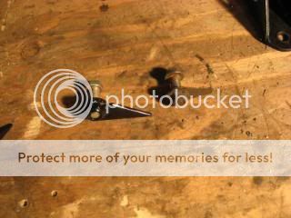

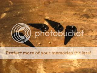

Some [not panel, but I can't think of the term] nuts I copied from Ford for the top of the shock mount;

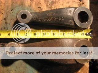

Here's some pics of the pitman arm, the small one is a '91 STX Ranger, the big one is a '87 STX Highrider Ranger. Looks like I'll have quicker steering;
