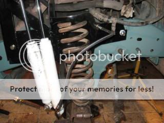

I got the brakes done. I used brake lines; Raybestos: BH 38622, BH 38623, as in this article;http://www.therangerstation.com/tech_library/ReplacementBrakeLine_Front.html. I pried off the metal clip that are half way down the line by using a vise and a large flat screwdriver. I also replaced the brake line between the two sides with a pre-made 60" line connector piece. The drivers side you have to get a 3 hole junction block and a 8" pre-made line to replace the drivers side line that has the hole for the 60" line connector.

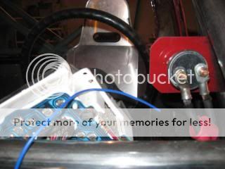

Got the battery moved to the back passenger side rear. Built a battery tray that will accept a marine battery box and used jumper cables that I bought at a yard sale for C$25.00. The cables are heavy duty 2/0 gauge. Ran a line from the battery to the 'emergency' disconnect mounted by drivers door. From there I ran to the fender well solenoid.I cut off the original battery end from the starter and soldered a lug on to connect to the solenoid.

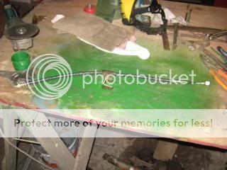

. I went to town and found a f-150 line, a bit shorter, that works with some tweaking.Also added a spring to keep the line away from the tire.
