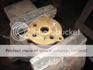

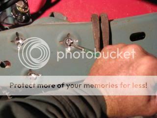

I have an electric t-case that wasn't working so I ordered the Shiftster1 and installed it.http://theshiftster.com/how-use-shiftster-users-guide Great quality and as simple to install as they say. I know cause I forgot the installation sheet at home when I went to install it, and it only took a couple of tries to get it correct. The only quibble I have is they don't have a neutral detente for flat towing so I added one, the silver dot is drilled so it just catches;

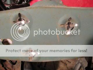

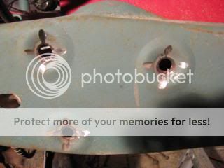

A pic of the top of the shock mounts showing the ribbing, it seems to work as there was no deformation;

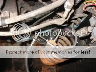

A pic of the brake line rerouting I had to do. These flex lines don't have a place for the line that goes to the passenger side so you have to add a three hole fitting and a 8" line. Also I added a spring from the flex line to the top of the coil bucket to avoid rubbing through it with the tire;

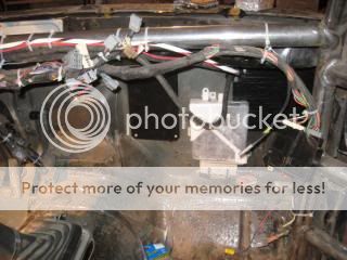

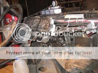

Tidied up the wiring;

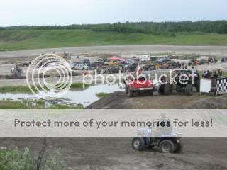

The Highriders club were having their meet, up for grabs was a spot at the King of the Hammers. This is the only pic I got as I was to busy working on my truck;

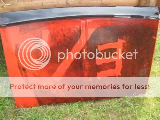

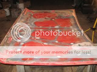

I'll be installing the hood and fenders and box sides right away, i just didn't have time. A pic of the gunge that was on the hood, the rest of the truck was the same;

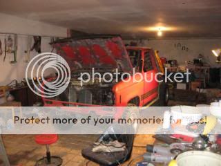

Started on putting the front end together/on;
alwaysFlOoReD's race truck
The bolt holes don't line up in most cases going from '87 to '91. Oh well, less bolts=less weight:icon_rofl:

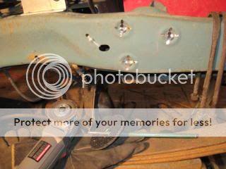

Cut the braces out;

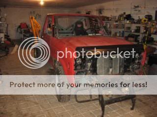

Button it up tomorrow, then start on the box. I'm going to try to mount the stock '87 bumpers as well as the bush bumper[maybe, maybe not]. I'm going for the '80's 'look', if there is one. Any one have a visor they would like to donate to the cause? Cracks are O.K. as long as the mounts are reasonable.I'll pay shipping up to C$25.00.

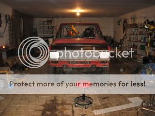

Still have to do the bumper but here's a pic as it sits now;
I salvaged some wire mesh and put it in the center and some light gauge white aluminum to fill the light pockets. If I have time I'll fill in the four holes along the bottom with mesh as well. Now to do the bumper then the box!I think I'll draw some eyes in where the lights go. Anyone want to draw some in to give me ideas?

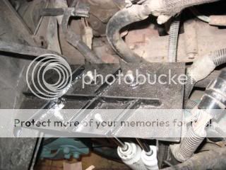

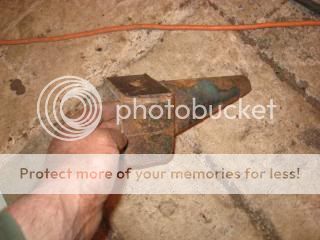

Also, today I spent 8 hrs on the back end of the truck; Removed stock frame shock mounts,

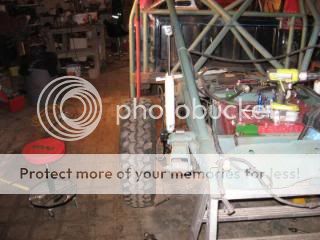

In order to get the shocks off, I had to move the fuel cell. I should have had it mounted over to the passenger side 2".

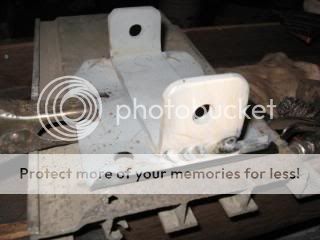

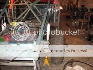

Built new mounts for axle and frame, welded on to axle plate;
As long as I had the plate off, I figured it was a good idea to remove the stock 3.5" lift block

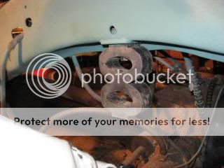

Spent an hour figuring how to mount these;
They are bump stops from a '89 cavalier? buick? can't quite remember. The same car I took the rad and fans from. Anywho...

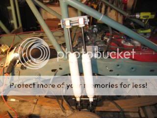

The shocks mounted on the bottom and mocked in place on top;
You might not have caught it but the drivers tire is a 29x8.50x15 Interco Super Swamper and the passenger tire is a 31x10.50x15 MT Baja Claw. I was checking clearances.

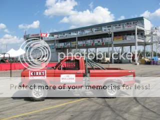

It turns out that this past weekend was a test and tune. The big weekend is this next one. We'll be racing at Castrol Raceway;
http://www.castrolraceway.com/
This is a new venue and should be quite a thrill as we will be racing at half time during the MONSTER TRUCK MADNESS!!!

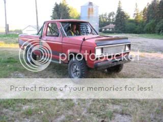

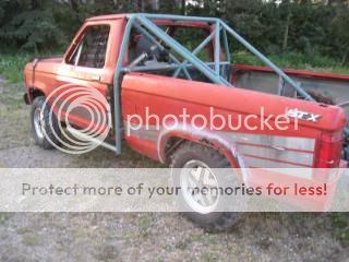

I got my front end and box finished enough to go to the test and tune. Only two trucks were able to make it, mine and Chuck's. Here's a pic of mine in front of the start line of the drag-strip;

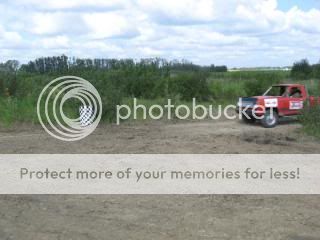

Only pic of mine on the track;
