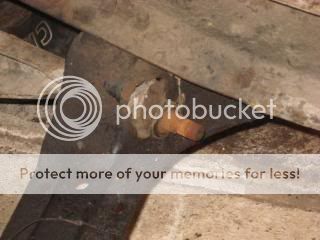

Not too much done. Take heed when grinding, especially with zip discs. Wear a full face helmet!!!! [ I wasn't but didn't get hurt. I did have safety glasses on though. ] I had one explode tonight and had shrapnel all over. I was grinding trying to get the f23king rubber mounts off. The system I came up with is to grind the nut off the bottom, then slice the washer off in pieces, then pry the rubber off with a screw driver. The rest just pulls out. This is with the cab lift up 2~3 inches.
I think I'm going to use the full 2" body lift 'puck' to mount the cab to the frame. My thinking is I'll have more room to work underneath, more room for a 302 swap in the future, and I can sink my seat down for more head room. This will lift the body ~ 1" higher than stock. Though plans can change.
