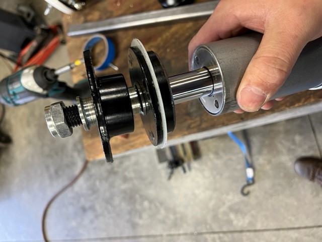

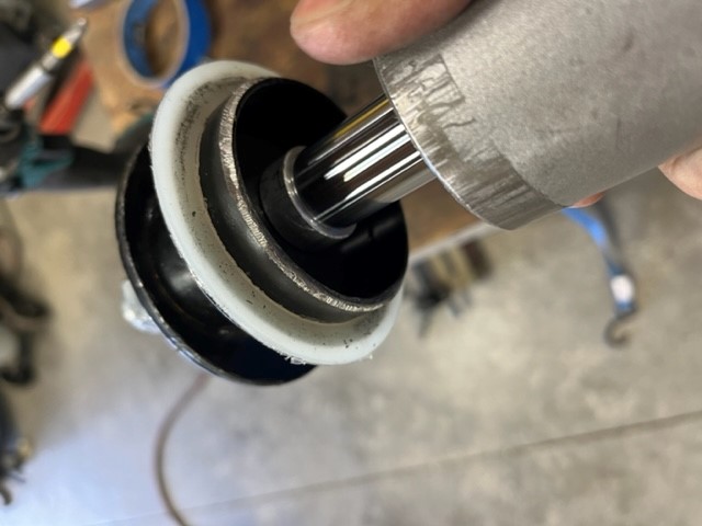

Here's how the strut spacers should be oriented. Now the spacer on the bottom could go anywhere but to have the maximum amount of drop you'll want it on bottom. Plus the top nut will clear the MC, but just barely.
