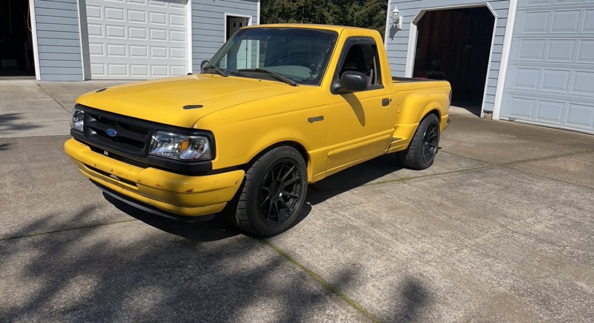

My truck currently sits on a 3" dream beam drop in the front, and an axle flip in the back. I'm going for low as well. SN95's are about an inch longer than fox setups I think. I've already got the racecraft drop spindles on order. They should be here tomorrow.

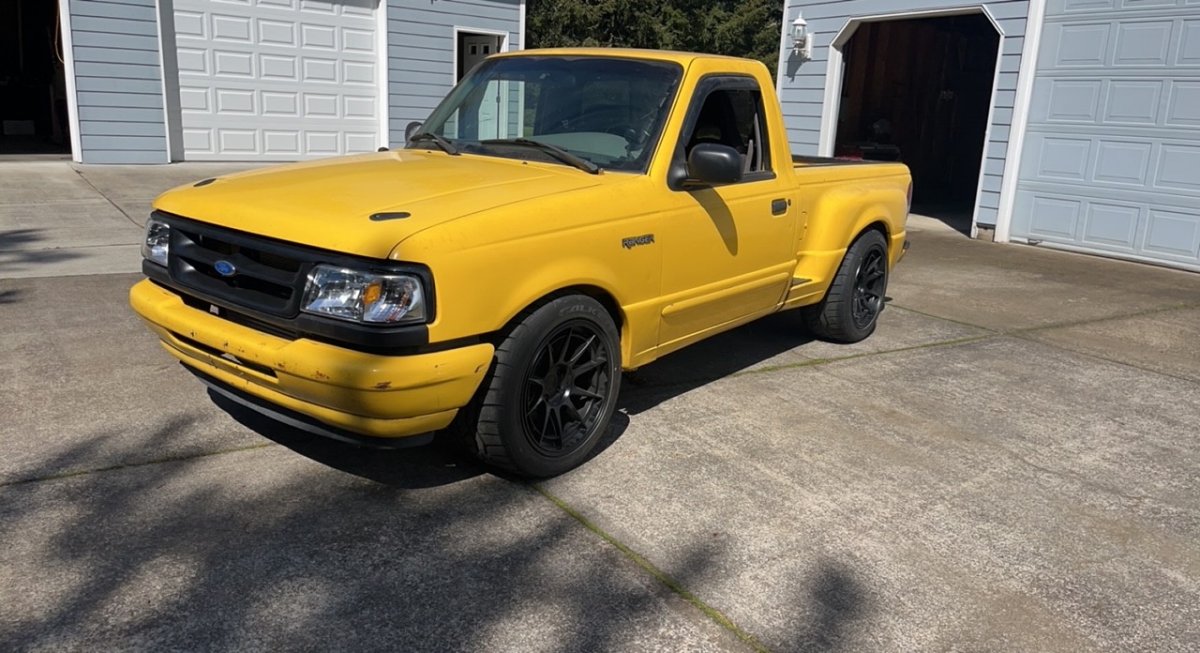

Photo of my truck for anyone interested, well prior to being flooded :rolleyes:

Fox Struts are 1.6" shorter. I do recommend them if you're trying to get extra low. But with drop spindles you'll be plenty low as is. I now have fox struts on 2000 spindles with a 27.3" tire and a 1.5" fender gap. If I don't end up installing flares Ill leave it. With drop spindles on sn95 struts on my setup I could get that gap down to 1".
