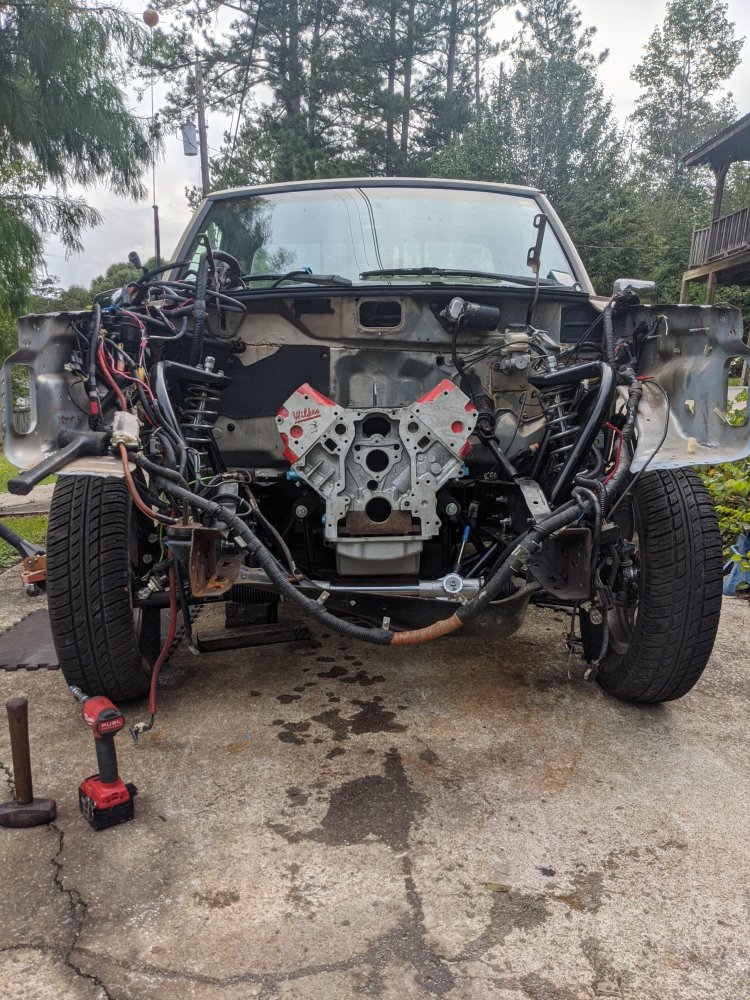

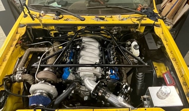

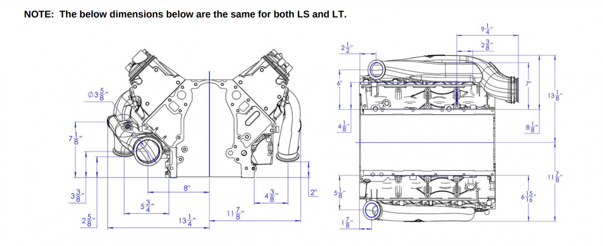

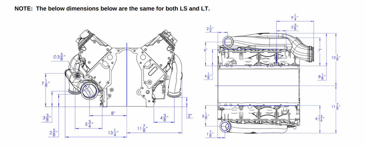

I gotcha. Look carefully at the drawing, then at my engine location relative to the frame. Most of my clearance issues are on the top of the frame channel on the pass side, and the steering column on the other.
Where the Holley v-band exits is exactly where I have a lot of room:

A lot more expense, that's for sure. Again, I could have done it cheaper, but I've ridden the roof of one going about 140 and I want to avoid that scenario if possible. I'm actually taking a chance by using copper tubing and silicon couplers at the Y manifolds.

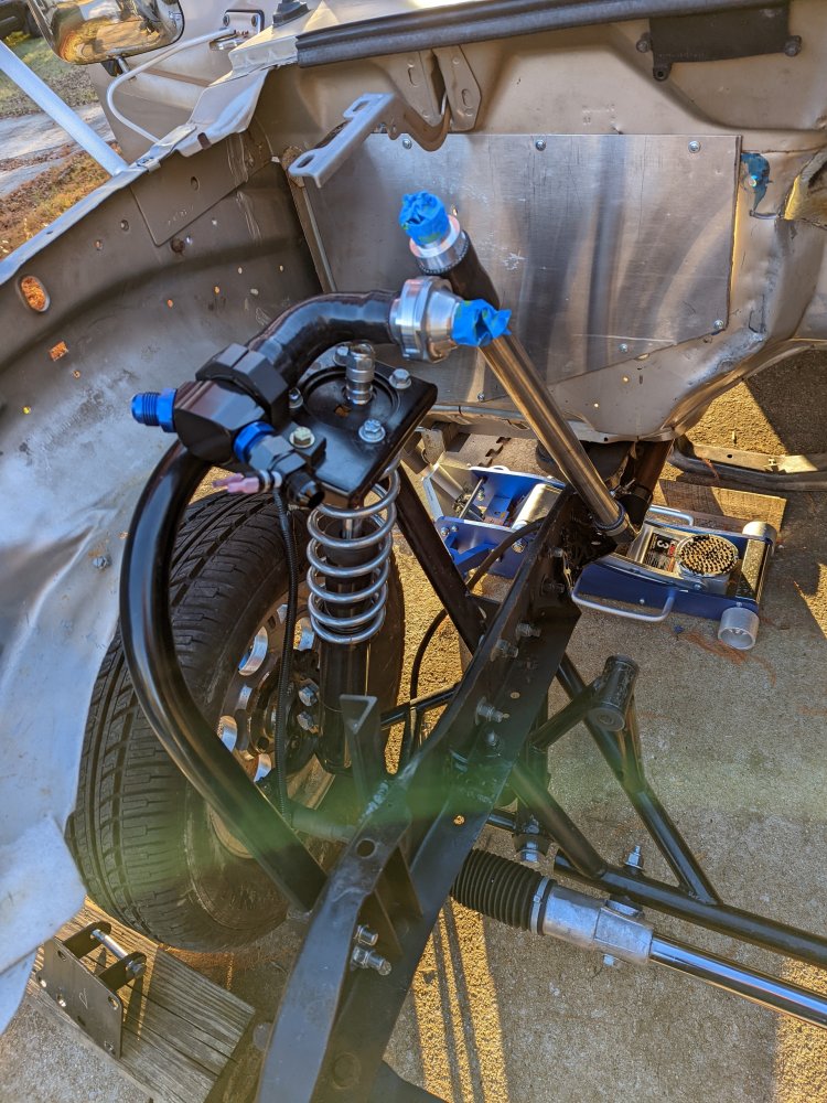

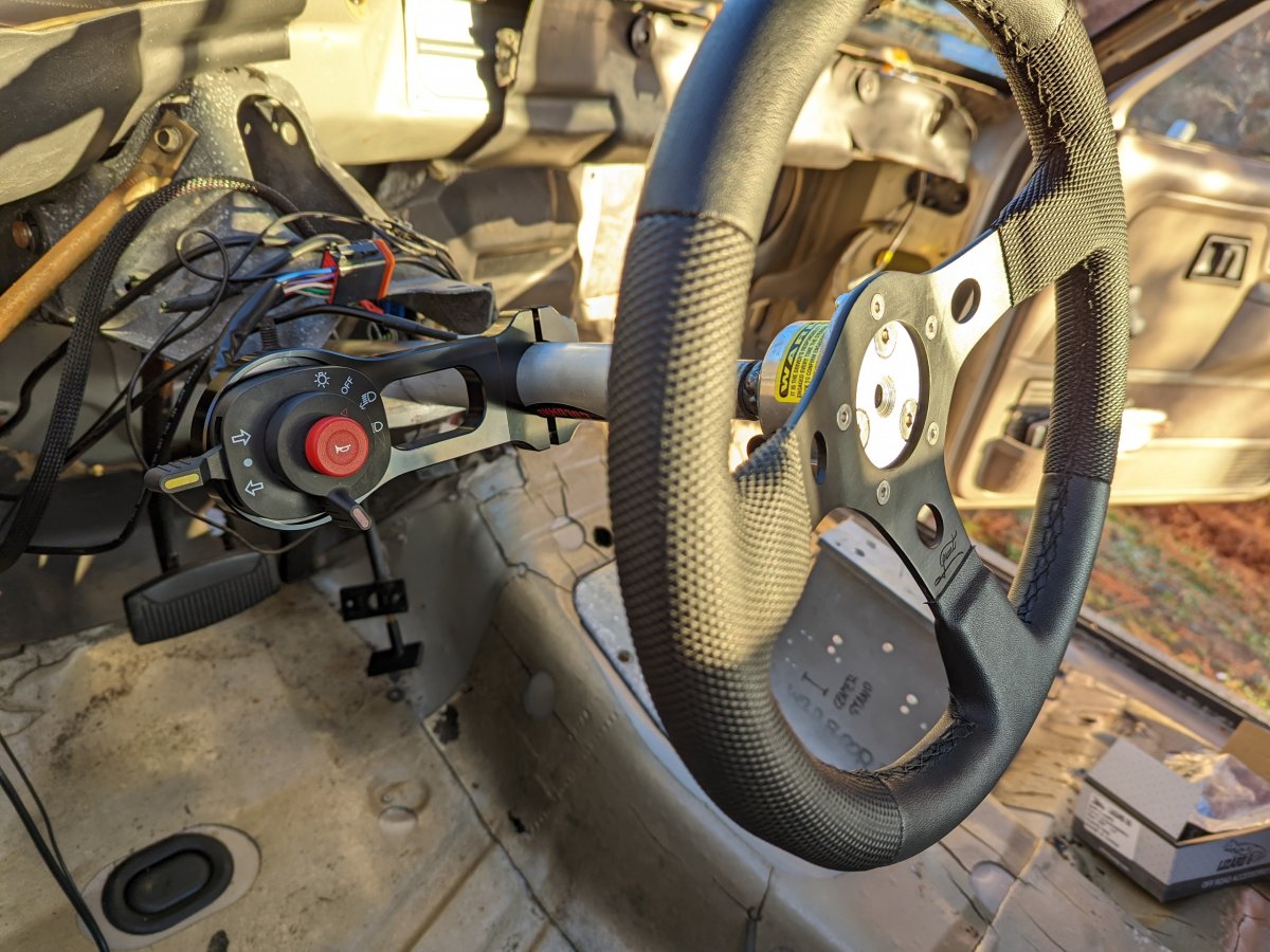

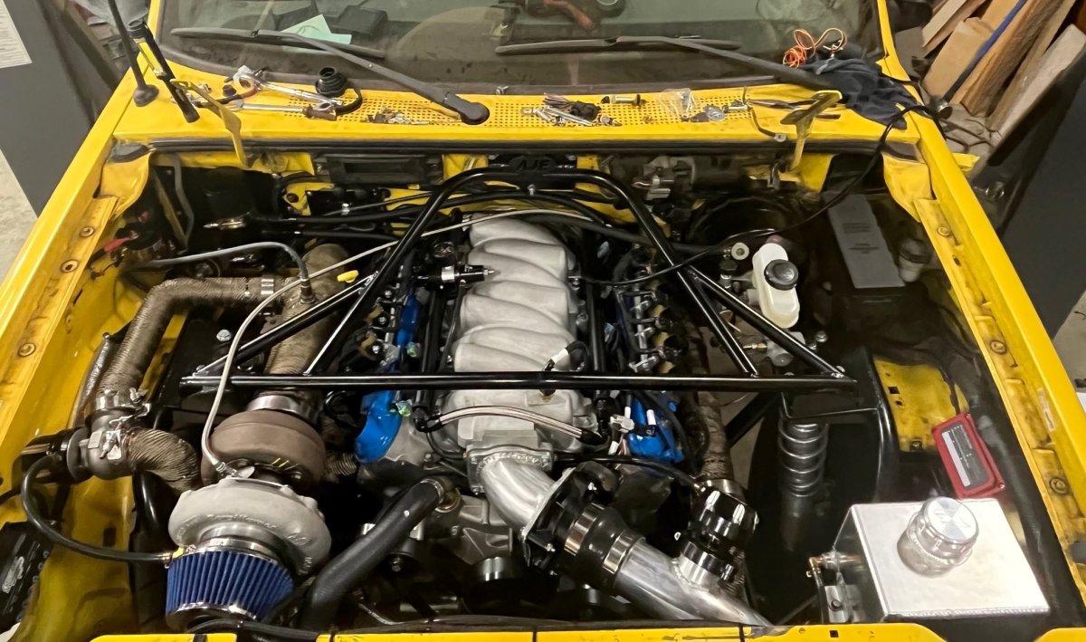

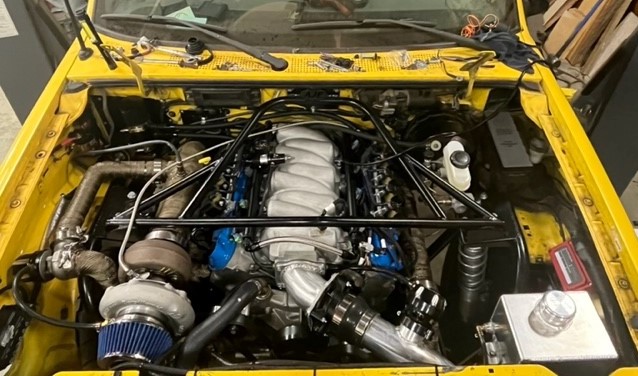

I started gutting the interior for my cage. If you look close at the 2nd pic above, I'm tying in the open ended 1.5" AJE strut towers to my dash tubes and cross brace. I'm also tying the motor mounts to the frame with 1" (0.250 wall) DOM tubing. That is how much flex is in these strut towers. I'll say it: It's not well engineered, and I don't think a ME was involved in it at all. The motor plate helped a ton, but not enough to make me feel safe during a pass (or with my wife in it).
S&W won't have it made for a few weeks, and I asked that they revise the belt / seat crossmember like the S-10s (adds more legroom because the crossmember is closer to the rear of the cab..it's two bends at each end). I have plenty to do in the meantime- wiring an entire vehicle takes time. FWIW, Racewire did the entire harness and bulkhead connections. See below for some of their work (billet turn sig / lighting / horn assembly)

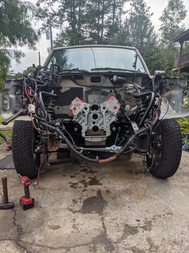

Gutted (the stock dash and cluster will go back in right where it was):

I really like that multi function switch. If I end up going with a race column I'm going to use that.
