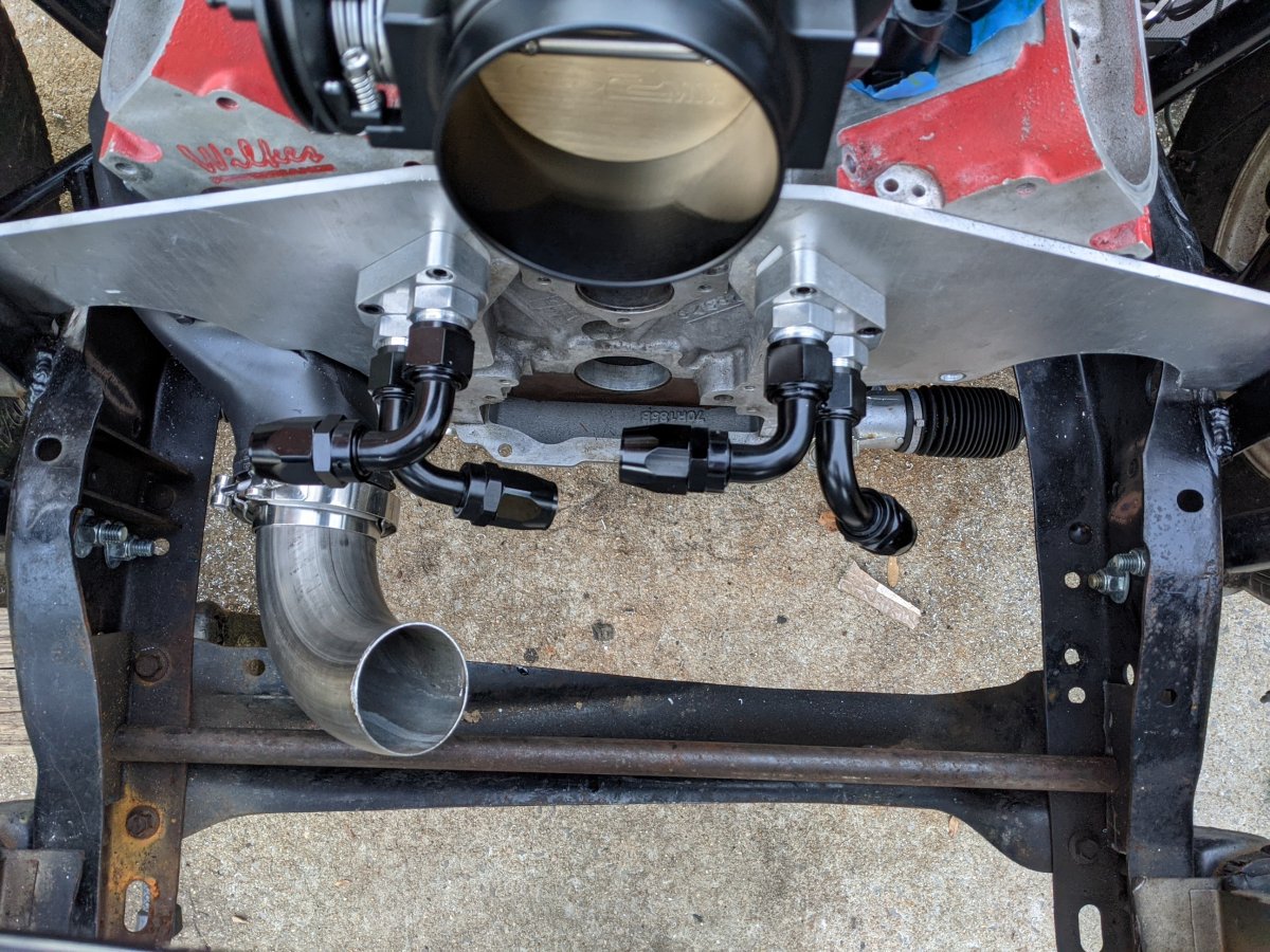

The motor plate solves many other issues, like where to mount stuff, removing the crappy woller-the-hole-out LS mounts so I have additional room for my exhaust (and WG dump routing options). I'll be using a Mezeire remote WP for the extra cooling it provides, (and room) as well. Pics when I get it completed.

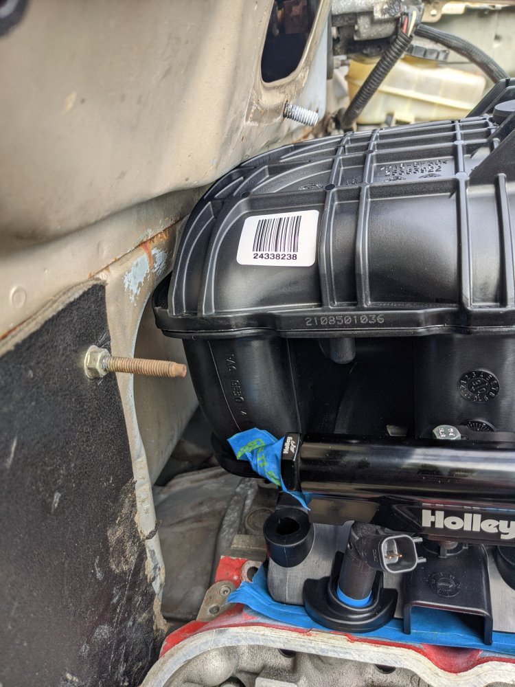

One again, we find ourselves with a plasma cutter and grinder in hand. The TBSS intake manifold fits with the engine set back 0.750" inches, but not comfortably:

The Isuzu "large NPR" intercooler fits like a glove in this truck, with room to spare (in front of the core support as pictured only if one modifies the support). I had considered doing A-W, but I had this I/C on hand and I'm not making a bluezillion HP- and I may go Ethanol at some point, anyway. It's not perfectly square, but I need more hardware before it finds its permanent mounting.
AJE Ranger K-Member Who's Done It!?
The TBSS intake, fuel rails and TB fit well. One can definitely see the benefit of moving everything to the bed, here- even if you are not a drag racer; I have a ton of room (14" from side to side) for the hot / cold side piping, WG dump and turbo now.
The rear-mount cooling system uses a remote 55 gpm Mezeire, 31 x 19 aluminum radiator with 3000 cfm fans, 1.5" copper tubing (type L) front to rear, and about 6' of 12AN (2' hoses for bottom WP flanges, top WP flanges and to water manifold Ys (qty 3)).
