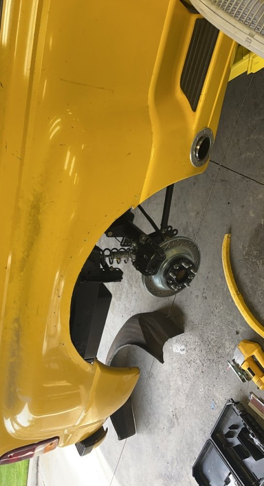

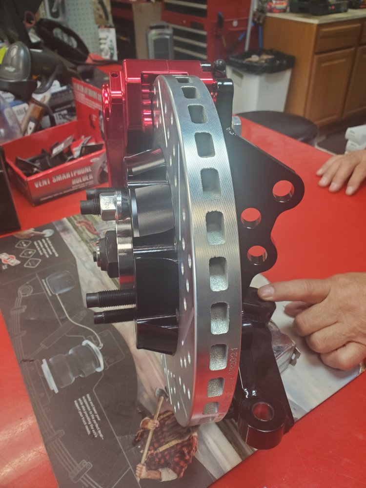

Quality of the welds and the machine work on the Racecraft seems very good. Mocked up the Bear brakes to check for fitment issues and so far so good. Pardon the wrong rotor on the wrong knuckle.

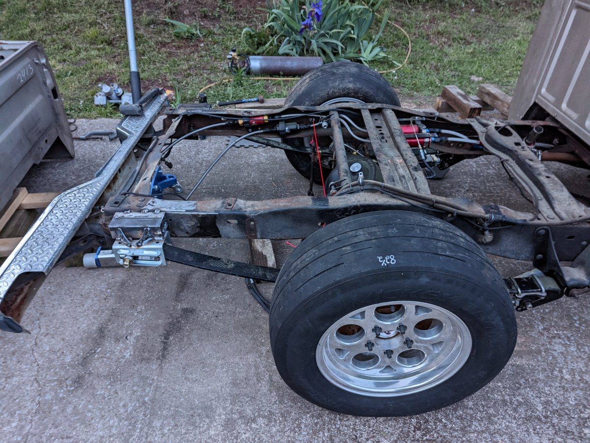

Here's where I'm at presently. I just finished setting the rear ride height- I'll call Viking with the particulars tomorrow and get them going on my fr / rr shocks. I'm using Calvert split leafs with sliders- I dropped the rear of the perch ~2" for additional leverage. It was work; the frame rails are really too narrow, so I boxed in the frame where the sliders weld to the frame (via 2x3 gusseted tubing). Disregard the tack welds- I was running out of gas.

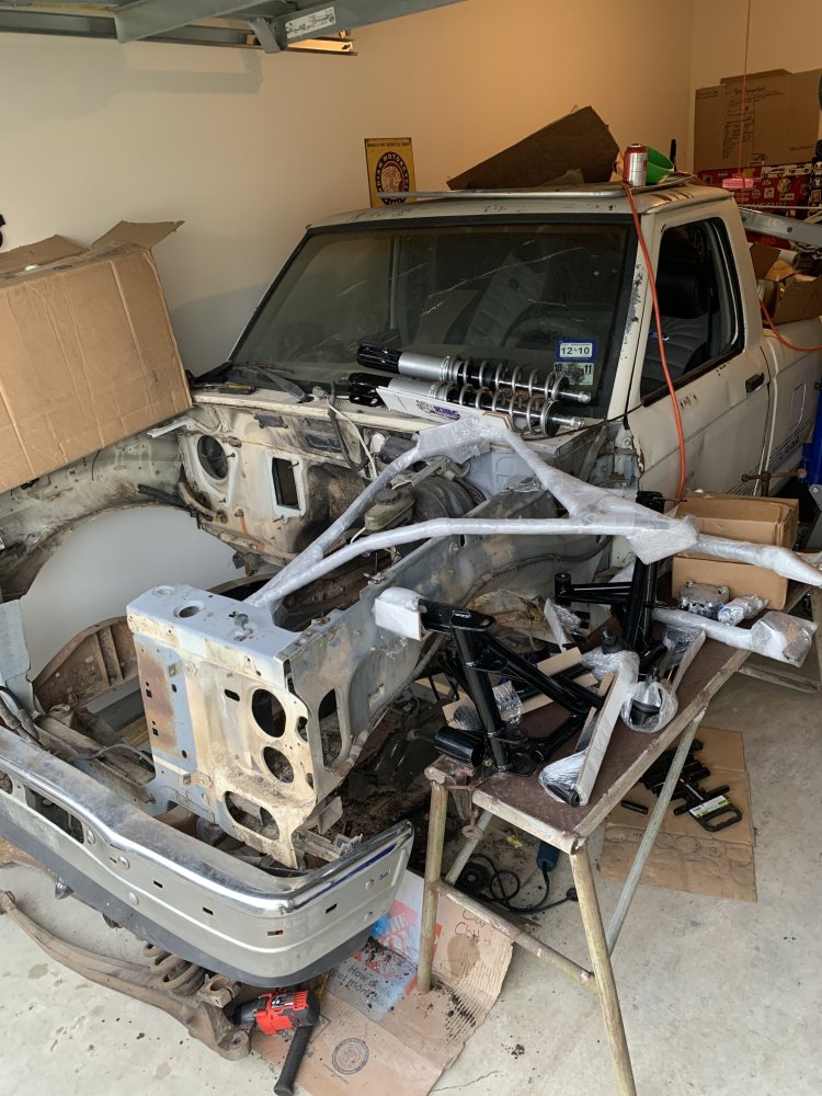

It’s here gents! Time for the real fun to start!

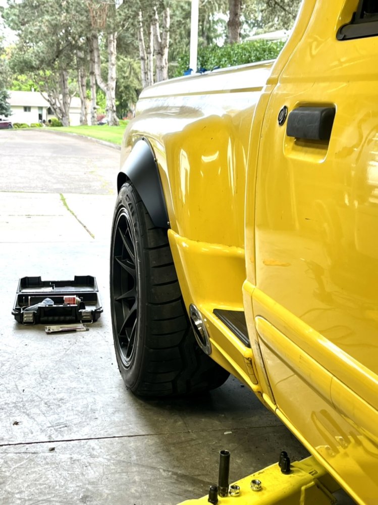

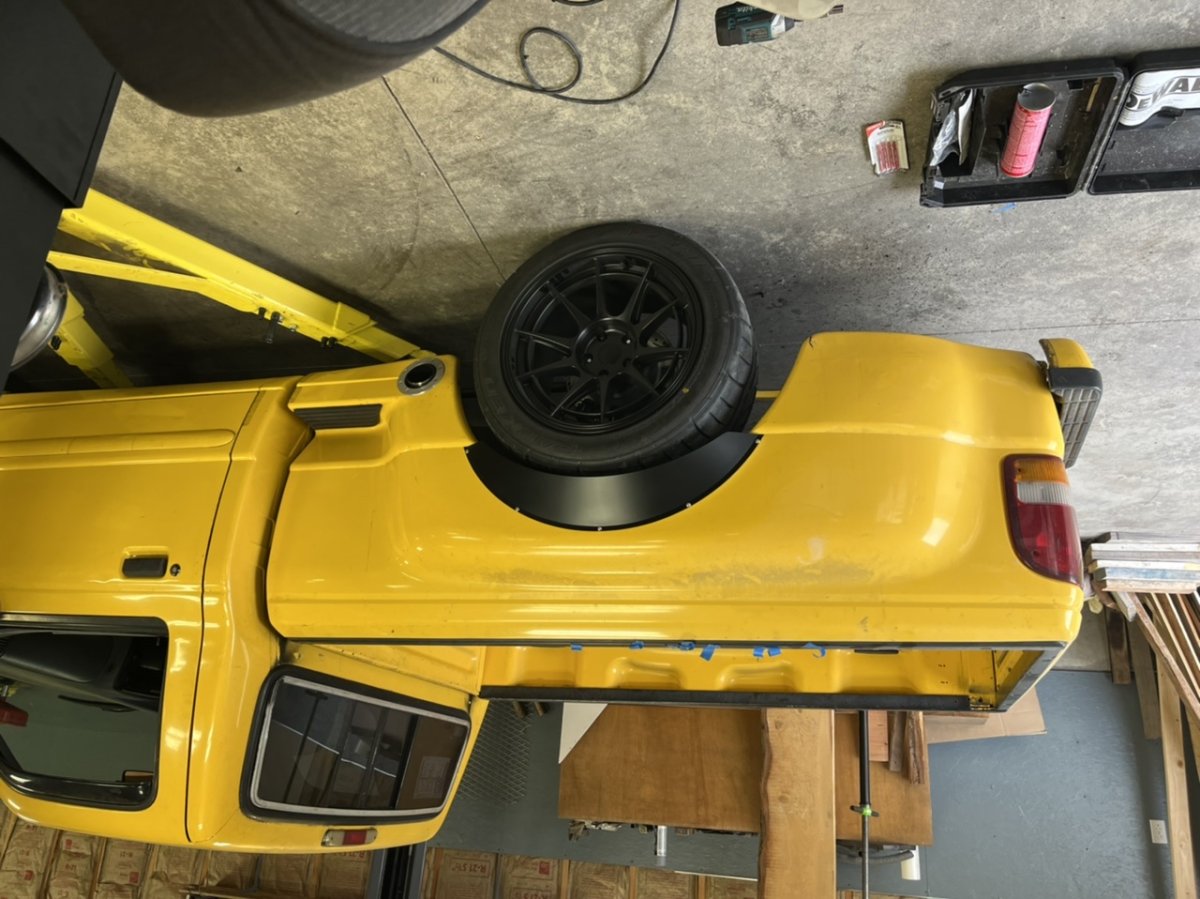

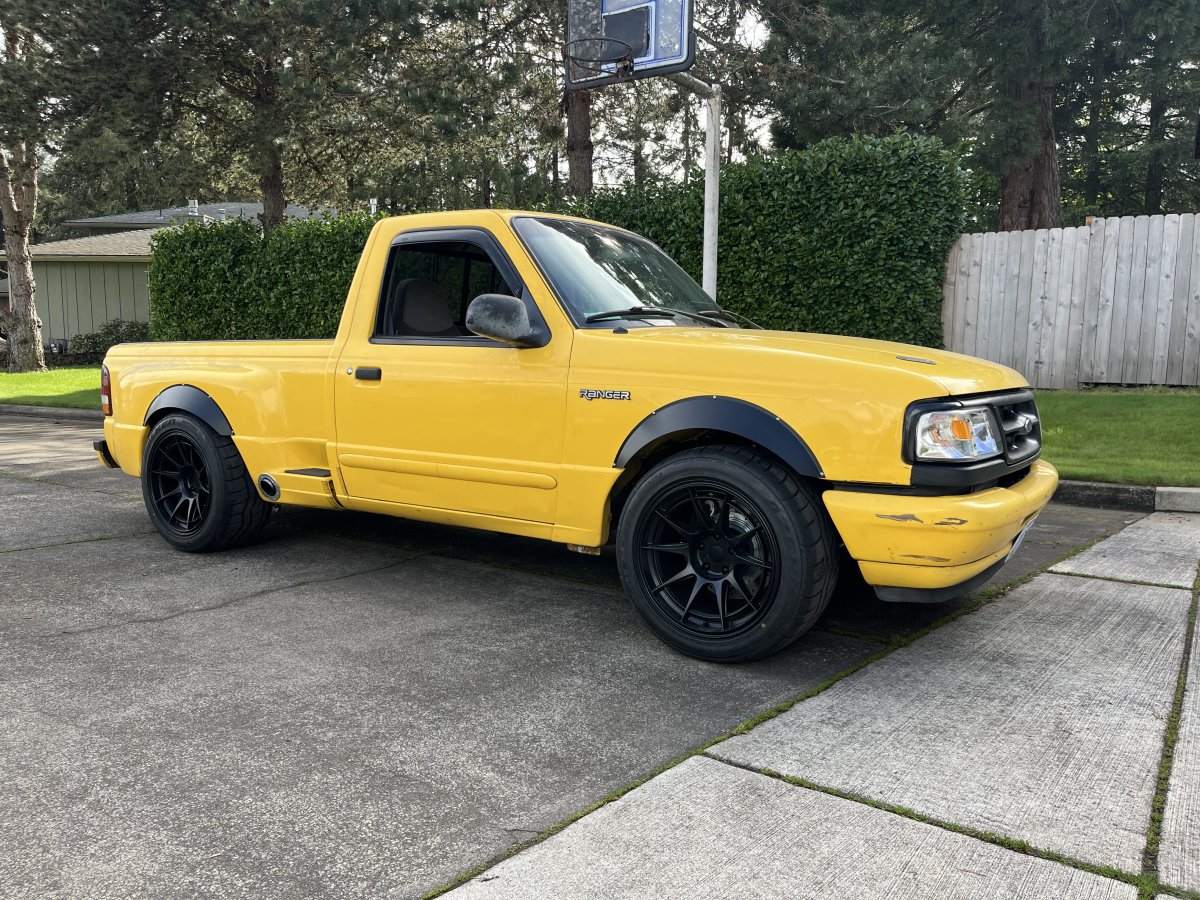

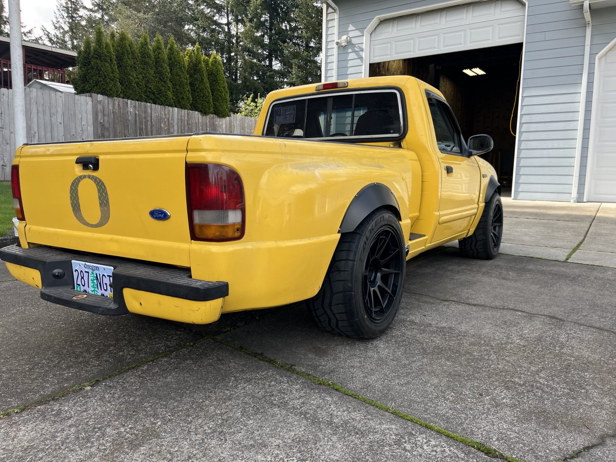

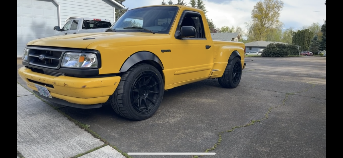

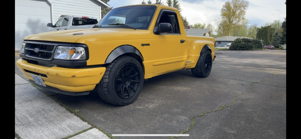

Found the solution I was looking for. Need to do the fronts and get drop spindles. This is a 2.75” flare with 1” spacers on a explorer 8.8 stock width. This will be final ride height in the rear. Not many options for flares. Tested multiple off Amazon then found these metal ones on eBay. Had to trim them a bit. Pretty sure I’ll mount the fronts higher then use the full 2” drop with spindles. Should level or be slightly raked forward.
Looks Fuckin sweet
Flares look awesome

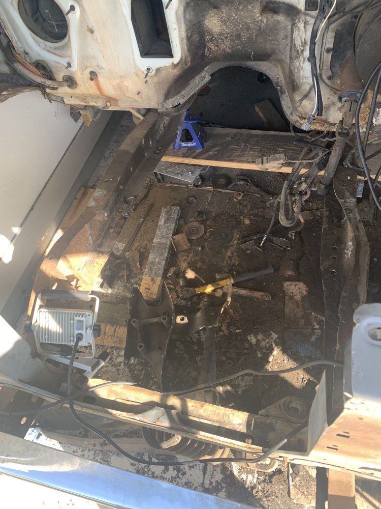

(Sorry for the shitty picture) Currently working a boat at my job and haven’t had much time to get out in the garage. Because I’m limited on power all I had was a cut off wheel and hopes 😂 but In the end I got it done. Frame is in better condition than I was expecting, the entire drivers side had power steering leaked on it for who knows how long and built up quite a bit of dirt and who knows what else. I have family coming in town this weekend so I’m gonna try and get out tomorrow after work and clean it up a bit I’ll post better pics and maybe even have a slight mock up

Im eager to start putting new parts in place instead of just cutting stuff out
