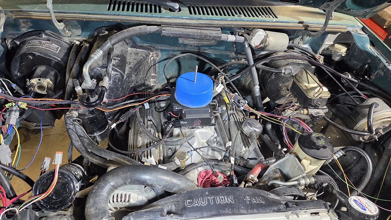

I got tired of looking at my hideous intake. I slipped the TB back off and started hosing it down with brake cleaner to throw some paint at it. And the darn thing cleaned up really nice and I didn't have to paint it after all lol.

It was blowing like crazy last night so I didn't get as much done as I wanted.
I did get the harness that goes across the front of the truck put back together and have the radiator and A/C condenser snugged back down.
I started routing the wiring under the heater box but I need to go thru that "additional wire" harness and pick out the wires I won't be using. I also think I am going to pull the front PS tire off to add accessibility... which I also couldn't do with the garage door closed.
I went to stab the dizzy in it last night and it hit my fancy heater hose elbow.
So I twisted on that a bit and now I think it might drop in... but I am not going to have much room for adjustment.
Collar clips hits the temp probe here:
Aces Killshot Fusion EFI Swap
Cap clip hits the elbow here:
I am thinking I might just go to the smaller IH distributor cab and lose the collar.
So since I had to back off the elbow I need to drop the coolant back out of it again and pull that all back apart and reseal it.
Also went to put the weatherpack connectors on the distributor and distributor harness and the wire insulation is starting to crack/rot on the pickup already so I need to replace that again.
I went thru the "additional wiring" harness and thinned out everything I won't need. Most pertains to things like aftermarket dashes (fuel level, TPS position etc) and different ignitions (tach in, sensor ground etc) So I have it whittled down to just needing three, Fan 1, Fan 2 and tach out. I have the rest coiled and ziptied to stash somewhere out of the way to make sure in fact they will not be needed until after this thing is up and running.
As it sits right now, I am really only adding dealing with connecting six wires to the truck. Inner fender and front PS tire is off to aide in routing the wiring on that side under the heater box.
