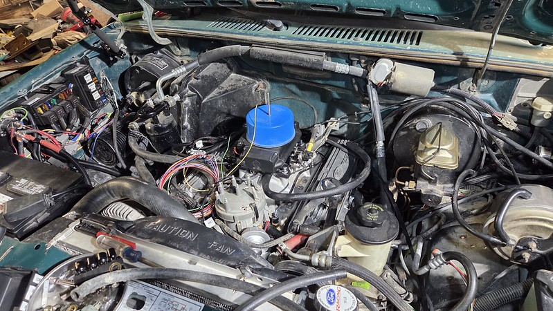

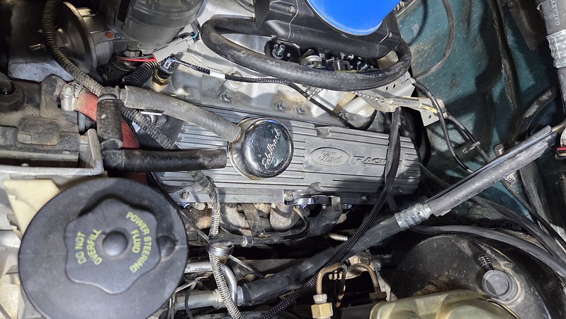

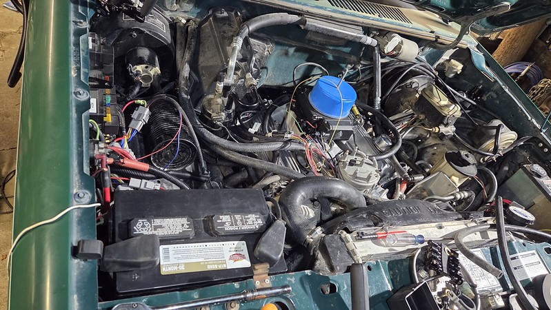

Alternator is back in, belt is back on, battery is back in. Power and ground is connected for the ECM.
Aces Killshot Fusion EFI Swap
O2 sensor is tight and yes both valve covers are back on.

I did get the return fuel line built from between the TB and FPR tonight. I don't have enough fuel line to get from between the TB and fuel filter. It was a short night Really muggy, june bugs were THICK and then a thunderstorm chased me inside.

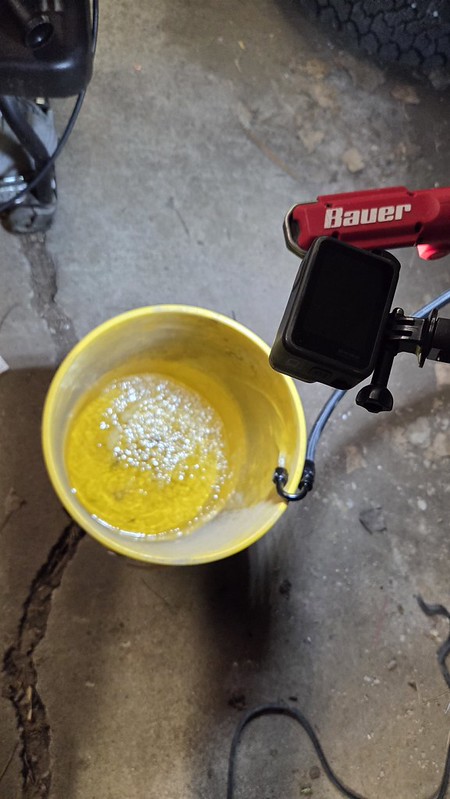

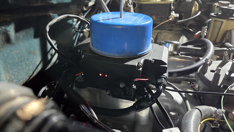

Main pressure fuel line is built and and I did flush it out.

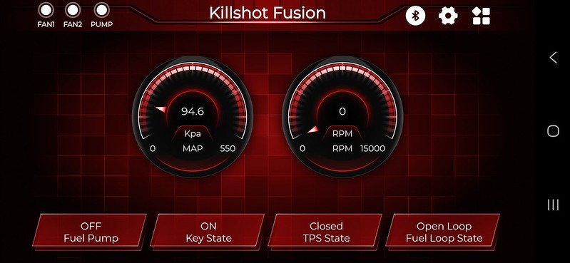

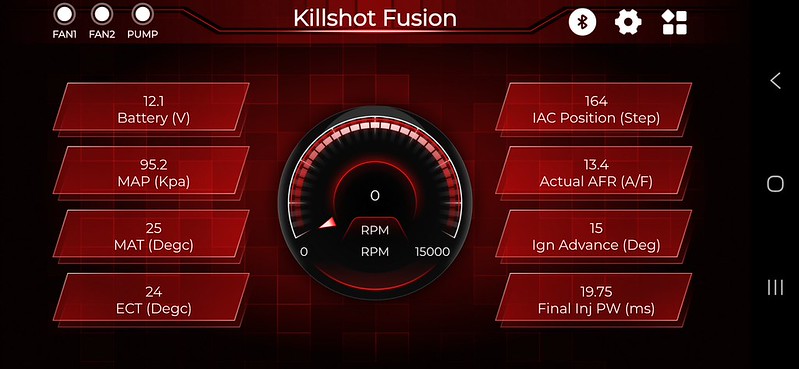

My truck is talking to my phone!
We still have awhile before I try to fire it but it was fun to poke around on there. We are getting a lot closer to lighting it off though!
