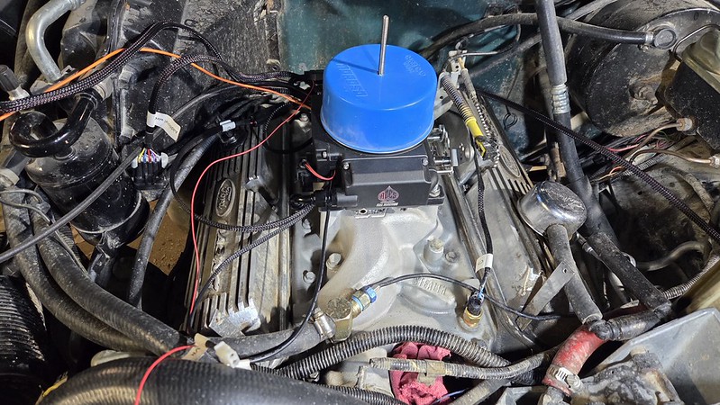

It was blowing like crazy last night so I didn't get as much done as I wanted.
I did get the harness that goes across the front of the truck put back together and have the radiator and A/C condenser snugged back down.
I started routing the wiring under the heater box but I need to go thru that "additional wire" harness and pick out the wires I won't be using. I also think I am going to pull the front PS tire off to add accessibility... which I also couldn't do with the garage door closed.

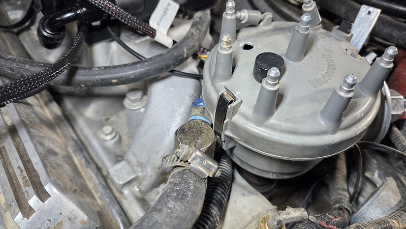

I went to stab the dizzy in it last night and it hit my fancy heater hose elbow.
So I twisted on that a bit and now I think it might drop in... but I am not going to have much room for adjustment.
Collar clips hits the temp probe here:

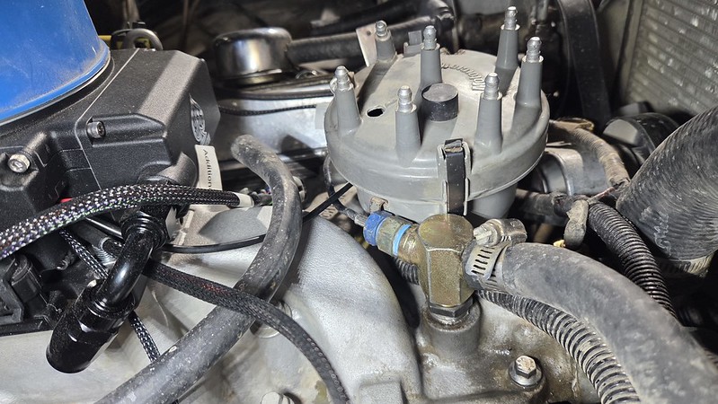

Cap clip hits the elbow here:

I am thinking I might just go to the smaller IH distributor cab and lose the collar.
So since I had to back off the elbow I need to drop the coolant back out of it again and pull that all back apart and reseal it.

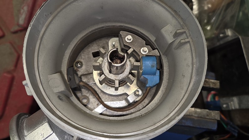

Also went to put the weatherpack connectors on the distributor and distributor harness and the wire insulation is starting to crack/rot on the pickup already so I need to replace that again.

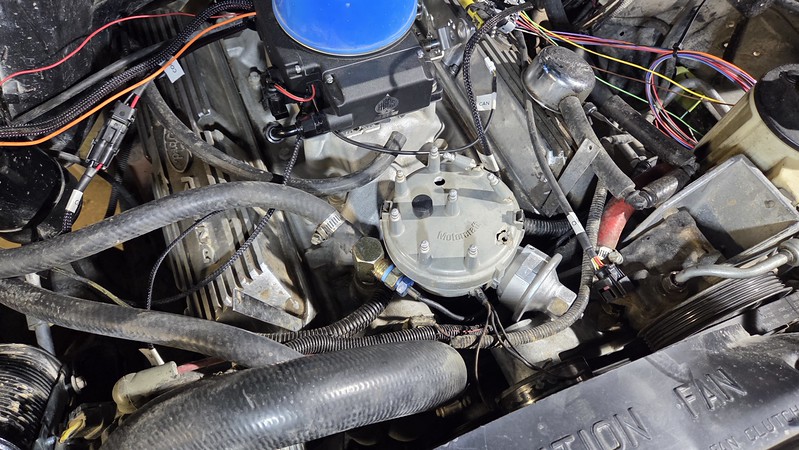

I reoriented the heater hose elbow to clear the distributor better. I also got the distributor installed last night, I don't think I need to change to the IH cap/rotor now which is nice. I still need to get a new pickup coil ordered for that to get the wiring buttoned up.
