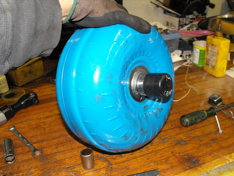

1st picture is the new torque converter,

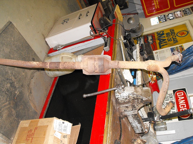

3rd is my exhaust that has been removed from the truck at the manifolds, I was lucky that I only had to torch one bolt, heated and impact gun on the others.

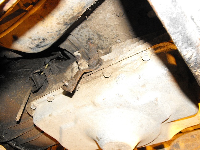

4th shows the linkage with the cables removed and what it looks like (of course),

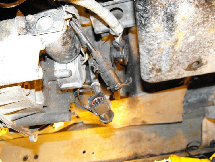

5th is the electronic push button transfer-case connector and the speedometer cable removed.

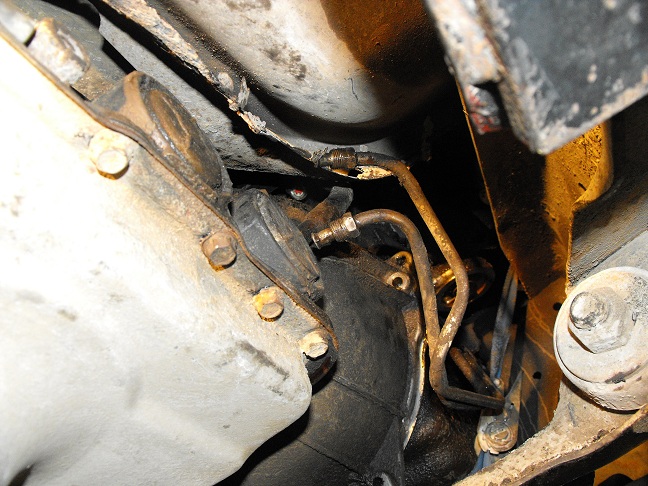

6th shows the cooler lines, nuts & their location (once again I recommend that you remove your y-pipe to do this job, it will make life easier), if you have an external or aftermarket cooler like I do make sure that the output line goes to it first and not the radiator. this picture shows the position of one of the bolt holes on the Trans (by the point the picture was taken we already removed the bolt.)

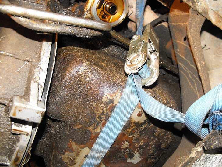

7th picture shows where and how we supported the engine from tipping back on us and destroying something.

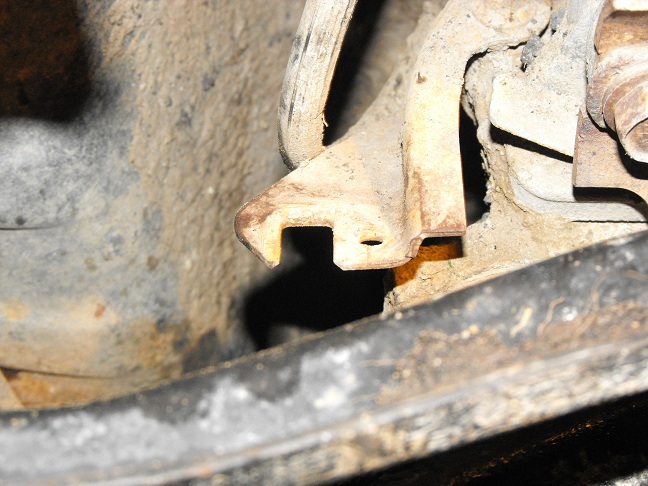

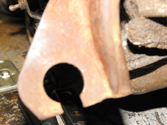

picture 8 shows the original bracket that held the shiftier cable
picture 9 shows the one on the newer transmission, so we just swapped them over.

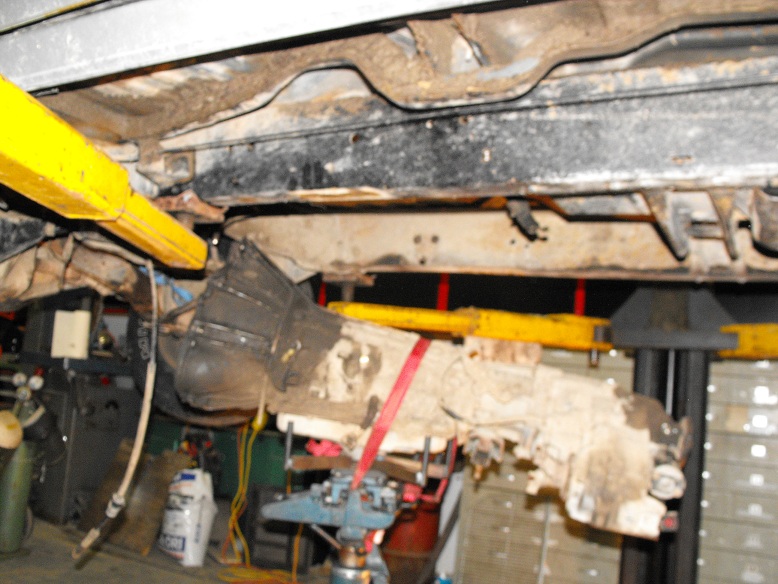

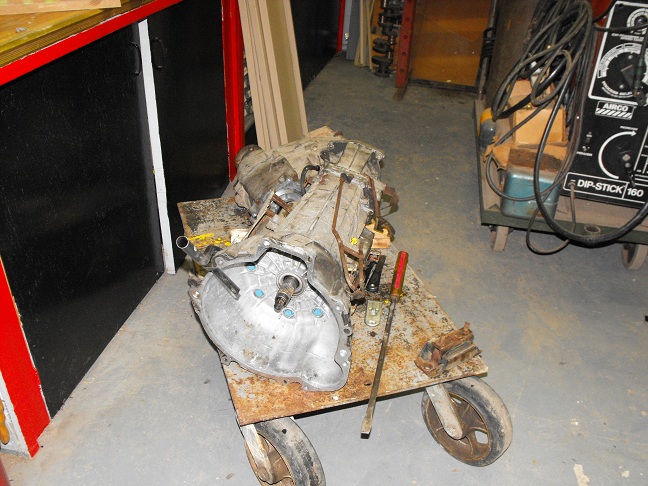

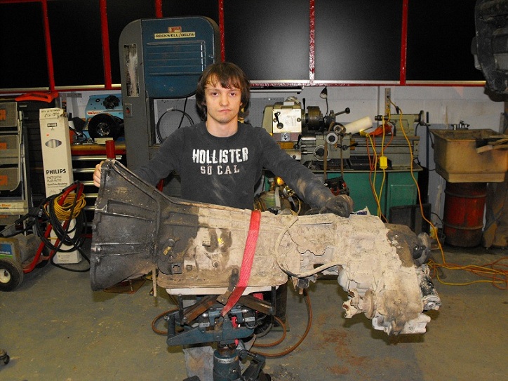

10th picture is the transmission on the transmission jack and it being freshly removed from the truck

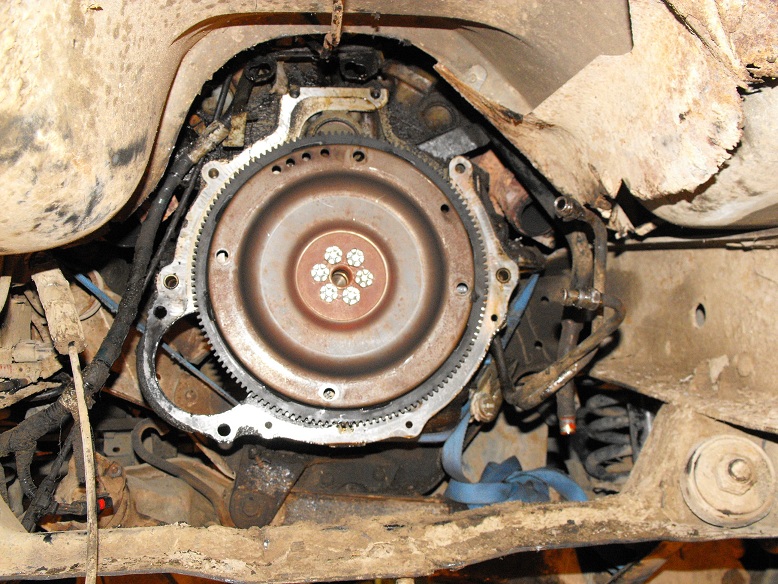

11th picture: after transmission has been removed this is how the flywheel looks, this picture also depicts the position of the dowels and the bolts that hold the transmission to the engine, the top 2 are the hardest to get off due to their position (13mm socket, 4ft of extensions, a swivel & breaker bar or impact is the easiest way), the 2 upper side bolts require some maneuvering to get off if you don't have a bunch of extensions and a swivel.
12th: the ugly old transmission and my ugly frustrated mug.
