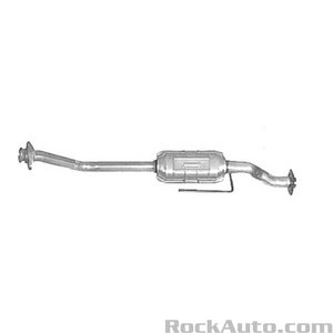

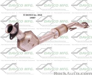

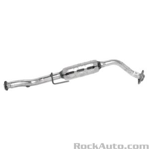

Rockauto lists 3 for a 1999 Ranger 2.5 with Federal emissions.
DAVICO 14687 E.P.A. Compliant Info
Fits Front; Standard Cab Pickup
or Front; Federal Emissions
Part image
$242.79
WALKER 54238 E.P.A. Compliant Info
One of our most popular parts
Part image
$252.79
AP / EASTERN 645897 E.P.A. Compliant Info
Direct Fit
Part image
$277.89
