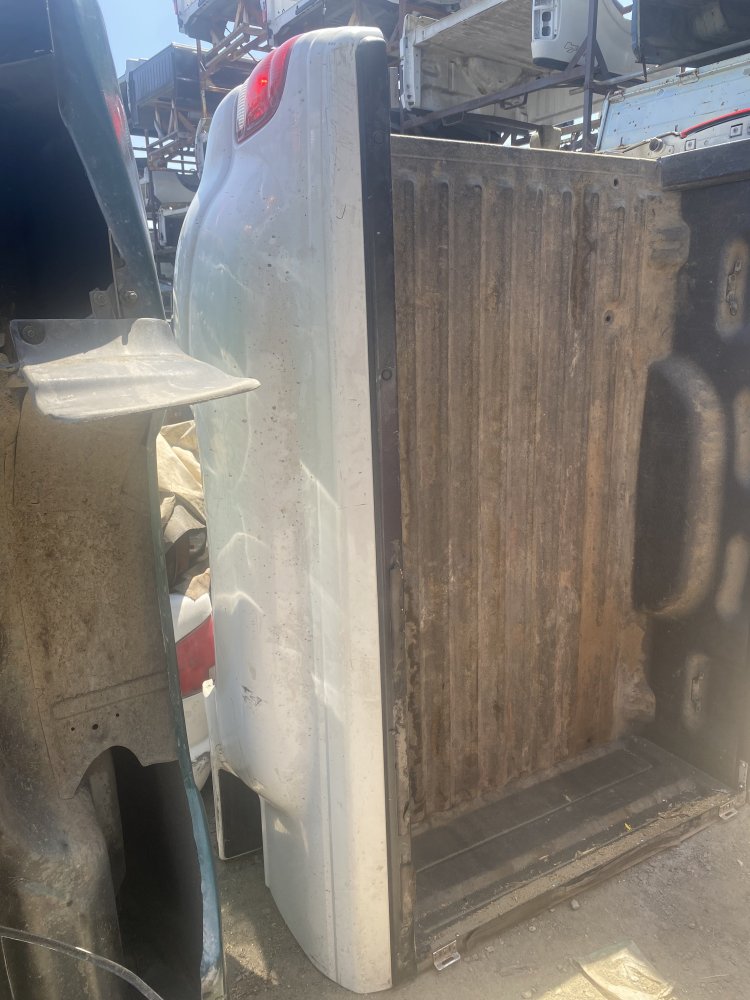

Don’t feel overwhelmed.
Simply put:
Any 6’ Ranger bed will bolt on, excluding the 2019+. (You’ll need other stuff if you go to a non “step side” bed.)
Any “stepside” Ranger bed will 100% work and line up correctly.
You may need to reuse your tail light harness depending on the year.
