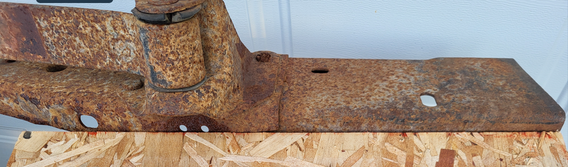

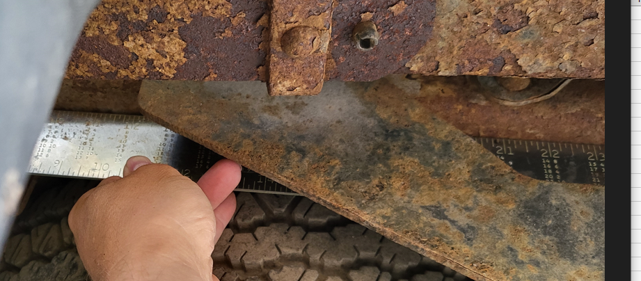

Pictures of one of my Ranger frames:
1st picture isn't greatest as I have hitch on, but the point is the framing square sits flat against the frame from the back to where the frame curves up for the wheel arch.
2nd picture shows how the front of the frame should be flat as well

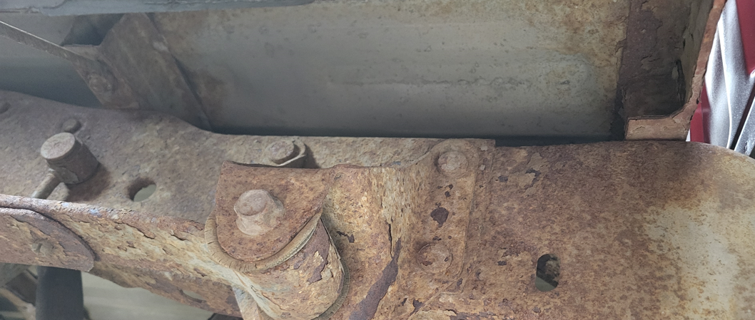

We also want to see if your box channels look like this or not
Mine is probably rustier than yours....

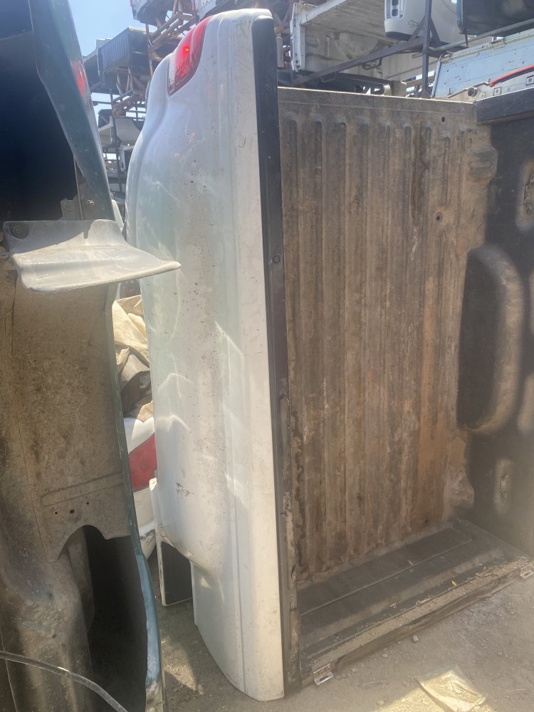

Well i am going to go with the cracked white bed cause its closer to me in the end. Both Fenders are cracked so i am going to swap my fenders on it. The place were i bought it from gave me a nice deal on it. 1000$
For the Bed,Bed install, fender swap, molding swap,tailgate put on, lights put on and they will dispose of my old bed as well.
Otherwise i was going to have to have the bed ship to me. With no place to store it i might add. Then take it to a body shop then have them put it on then have them dispose of my old one. Which would cost more money and take more time. I also found it difficult to find a bed that was in good shape that can be shipped to me.
I am not a mechanic and don't really have anyone to help me go pull a bed from pick your part either. So i went with the deal hopefully this bed is at least better than what i have. I haven't seen beneath the bed liner yet. I got to take a look under there before having it installed. There isn't any rust on the bottom of it.
Both fenders being cracked i wonder what happen to it? The Bed part aside from the fenders looks straight compared to mine.

those cracks look like ones that happen from careless people pulling the bed off and just setting it down rough or something like that. they don't look like accident cracks.
