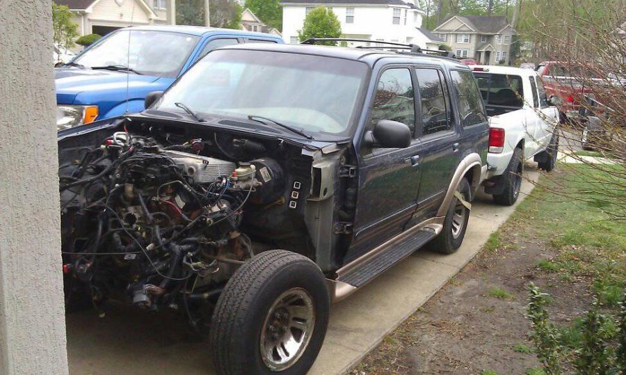

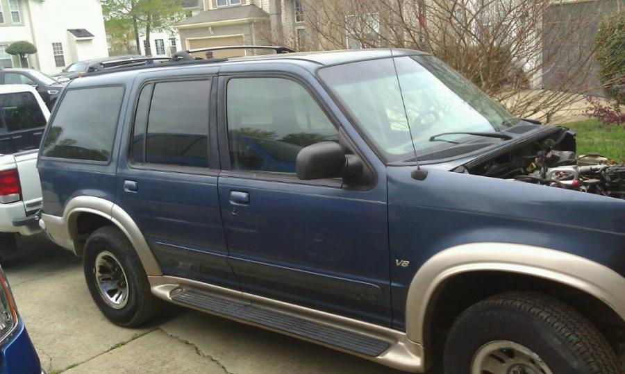

I have 2000 ranger xlt 2wd and Im doing the 5.0 swap with a 99 eddie bauer awd donor. the donor has minor front end collision damage and has 61xxx miles on it. I also have a limited access to a 95 mustang for small parts, and a 88 fox body jasper auto trans. I plan on doing a basic plug and play(to an extent) swap. and just wanted to ask if the 88 5.0 jasper auto trans out of the mustang will work in my truck with the swap. prob not right? and besides that any 4r70w 2wd should work right?.. I've been using the search button I swear lol.. but uuhh let me know what yall think..tips, suggestions whatever.. your 2 cents is valued here. :icon_pepsi: Also doing the disc brake axle swap too

Just got the donor today, apparently she has had the engine replaced, and the trans rebuilt previously, who knows. Po removed the ps pump,ac, and alt, but thats fine as its getting new ones anyway. And a water pump too as it was damaged in the accident. But yeah, thats her
