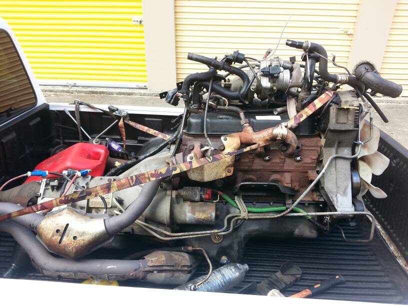

I know its been a while, busy with life and other swaps but i have my new engine and trans now!

The donor:
