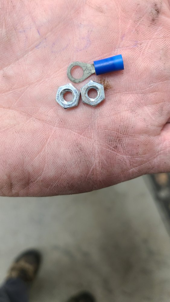

Image shows the aftermarket Sender with 2 wires and the other my Truck has 1 wire extra.....

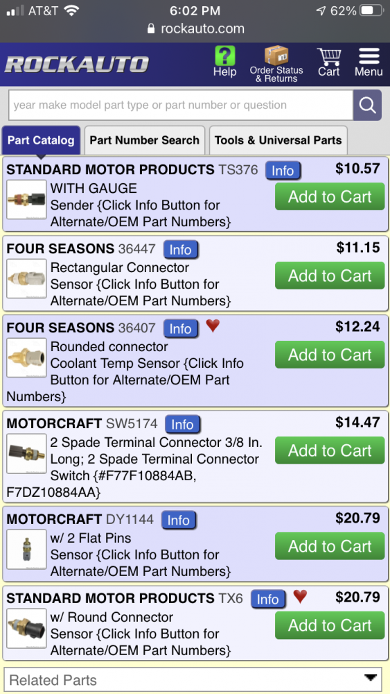

Where have you looked for the part you need? Just the Ford dealer? What about Rock Auto?
99 3.0L Ranger Temp Gauage sending unit.....
I checked all over for the one wire pigtail.....no go. Rock Auto I just checked as you suggested. It shows like 8 pigtails when you choose my Trucks engine 1999 ford ranger XLT 3.0 Gas.....None of them are 1 wire but all 2 wire. Heck, if I could figure out which one fits the sender I have then I can just try grounding the terminal myself.....they are like $7 each....lol. FORD wanted $75 for the pigtail.....but no gurantee I can get it to work.
I looked but am lost. Can you reference a part like the "Sender" and get a cross reference for the right pigtail? I see alot of mislabels on sender/sensor. Sender seem to have 1 wire...all sensors seem to have two so afraid of wriong part.

Yes. If you can use the 1 wire device, you don't need a special pigtail because it's connection is a threaded stud.
All you need is this;
And you connect it like this;

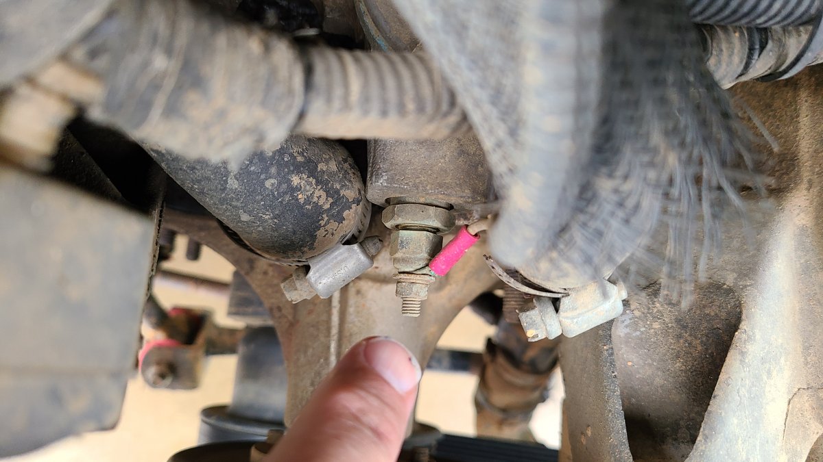

Thanks for all the help!!! I was going to splice in the 2 wire and ground just as you suggested as all I could find were 2 wire senders. I ended up finding the one wire switch/sender at FORD.....The "Sender" is a "Sending Switch" and shows up as a Single Pole Sending Switch at Ford if you ahve a one wire model. The pigtail for a one wire single pole switch is part number WPT-476 and was doscontinued by FORD. It is also easily confusing as the Sender is a one wire the sensor is 2 wire....the sender uses a switch and sensor connector. I found out that part/sensor is used also in the Cig lighter connector for like 700 FORD models....lol. So I got a perfect match and wired it in and repalced the Switch.
She sparked right up and Temp Gauge came on but comes on Hot.....stays hot. Like the switch was bad or getting bad signal still somehow.
I am going to go back and get the switch repalced as it may be bad even though it is new....since the temp gauge is now getting signal but unsure why it stays in Hot all the time?
Other gauges seem to work fine. Though time to time all 4 orange lights come on gas/temp/oil/voltage....but then go away.
Any ideas or indication of what I may have done wrong would be appreciated. Getting close!
Thanks for the support the pics are appreciated!
