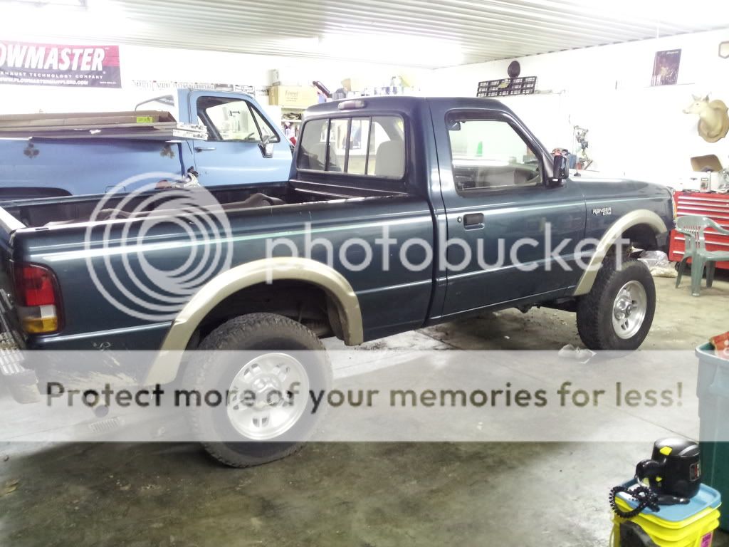

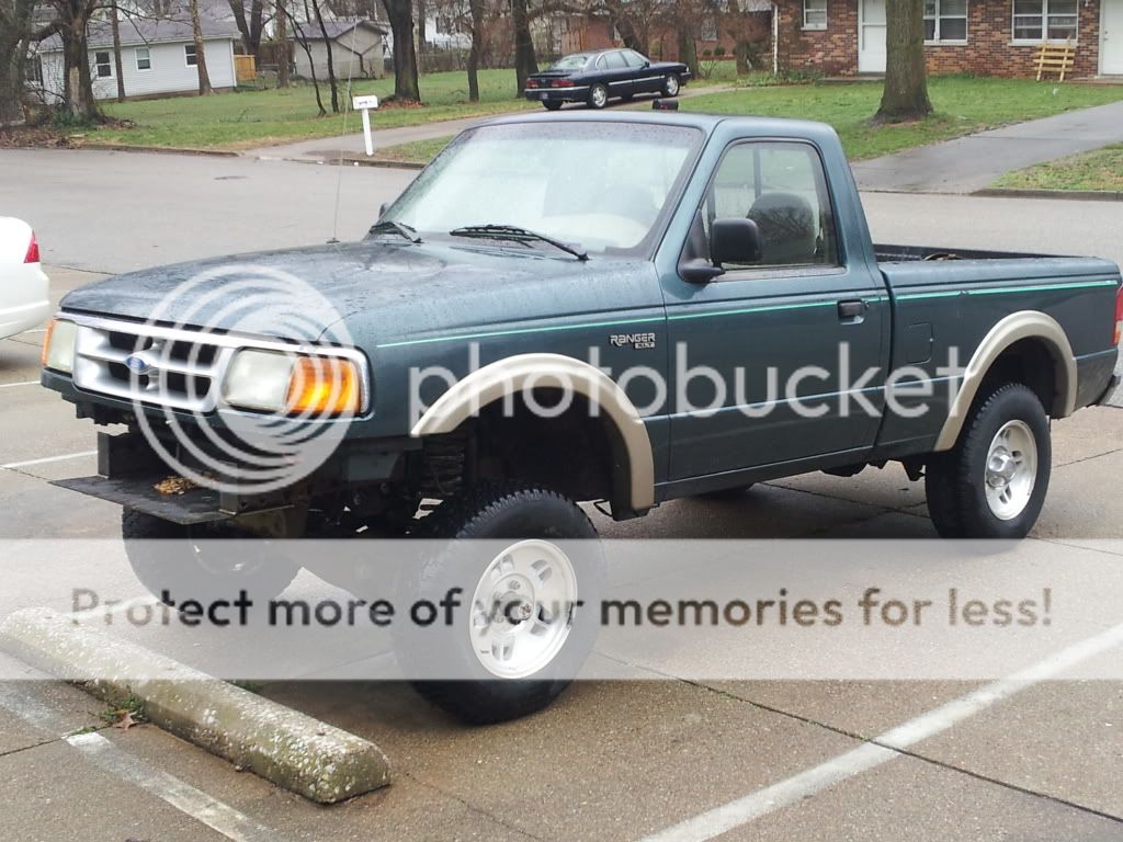

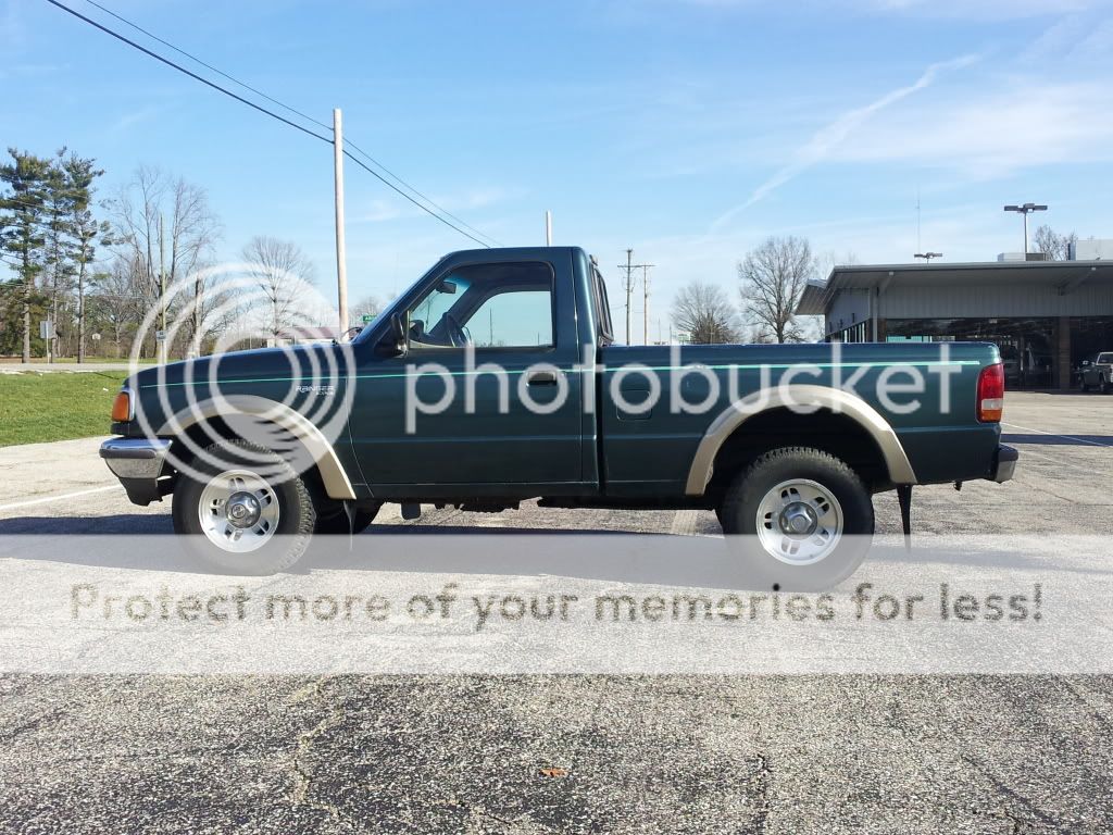

Here's a pic of how I bought it. 190,xxx miles, 4.0, 5spd, 3.73 with l/s.

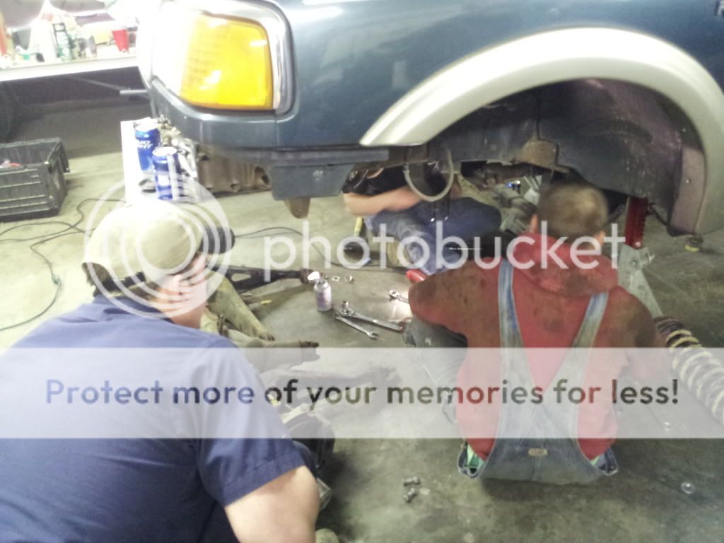

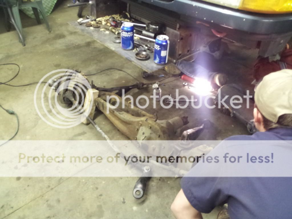

I bought a pieced together 6" lift kit off of a member on here local to me, I think his name is deciplerocks. Here are some pics of me and some buddy's putting it on and how it looked.
more pics

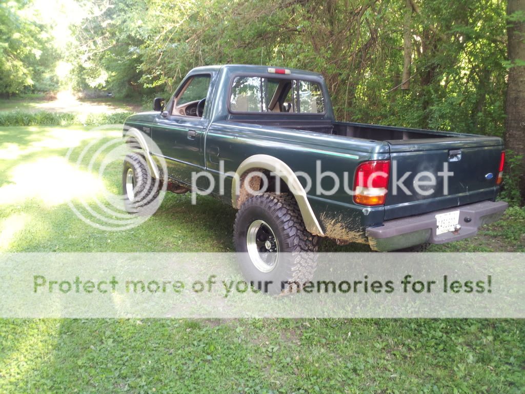

I put some of the autozone shackles on the rear and it helped level it out. I got some front shocks from Greg(97trailrigDD) and bought some james duff shocks for the rear and removed the front and rear sway bars.

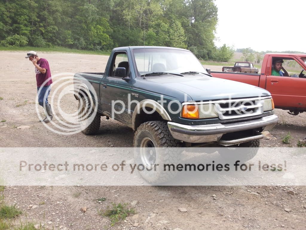

I bought some rims off craigslist soon after the lift was on. They were a little more fancy than I was looking for but couldn't beat the price so I bought them. My Dad had a brand new 33x12.50x15 procomp M/T at the house so I bought 3 more to match and got them mounted up and on the truck.

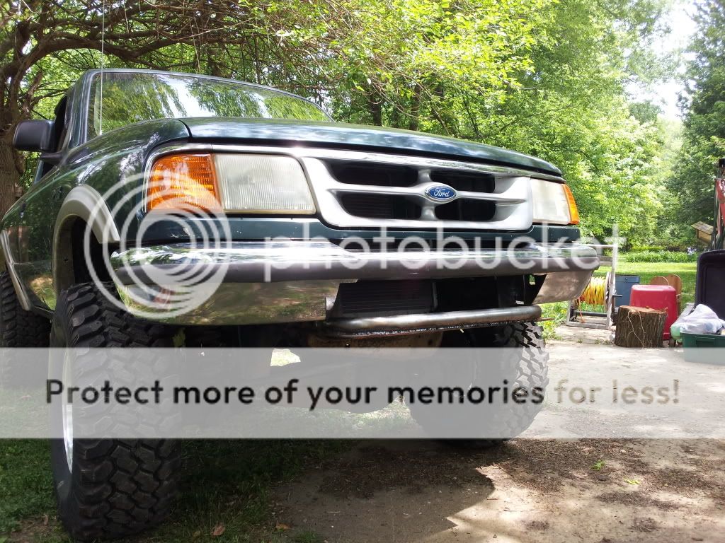

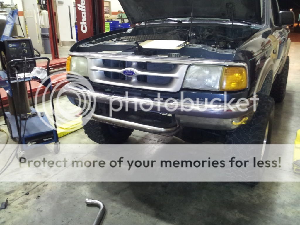

While doing the suspension work I was also slowly working on making a front winch bumper. I was originally wanting to do a full tube front bumper but since I was making it at school I was running out of time before the semester was over so I simplified it.
I added another bar a couple inches above that bottom one, but I don't have any good pics of it. you might be able to see it in the other pics. the top bar is removable so the winch can be removed. I still need to add some front and rear tow hooks and a fairlead for the winch, but its mounted and wired up now.

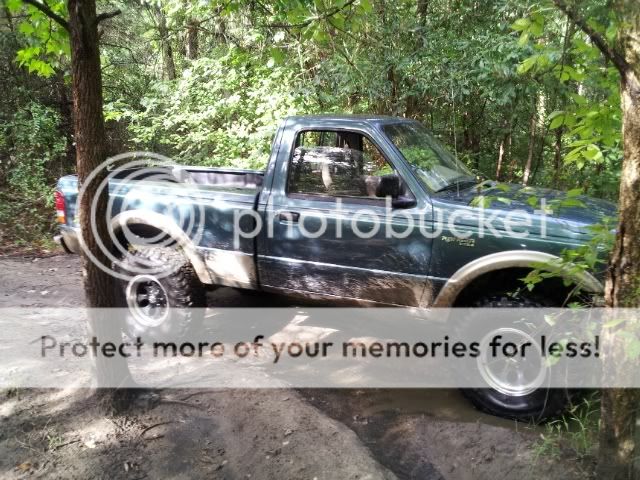

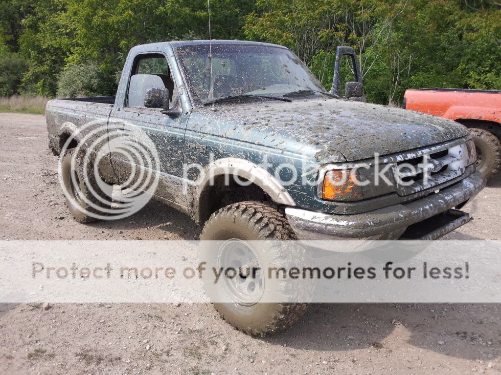

I finally got a chance to take it wheelin' for the first time a couple months ago. Me, 97trailrigDD(Greg), and another buddy in a Toyota on 33s went up to Interlake in Lynnville, IN.
Here is a pic of right before we headed into the woods on one of the trails
And this is about 30 mins later after Greg dragged me out after one of the junk auto hubs let go.

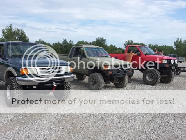

It had been really dry and dusty this summer so I didn't have a desire to get back out there until last weekend when we finally got some rain. Me and a couple other buddies with Toyotas took a trip out there.
before we hit the trails
The green toyota only has half bald 31" A/Ts for right now, and other than a suspension lift is stock. The red toyota has a sas with leave springs in the front, 35" tires, but stock gears and open diffs.

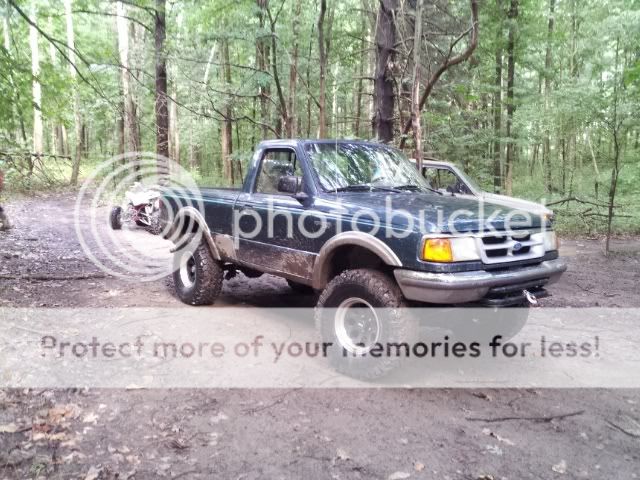

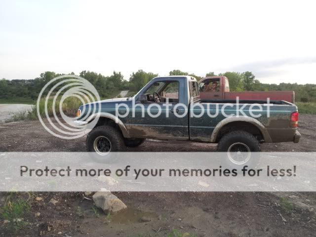

Here are a few pic of us on the trails when we stopped for breaks.
those trails were pretty tame but still a lot of fun for us. I didn't get stuck and didn't break so it was a good trip.

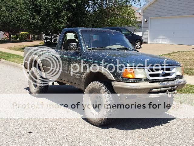

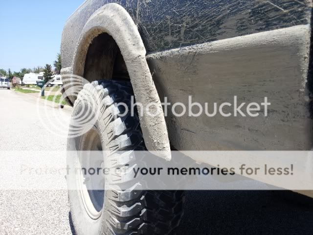

My buddy with the green toyota and I made another trip out to Interlake this morning. We got a little more rain last week so it stayed decently muddy out there, but not bad. We ended up on a more difficult, tight trail than we took last week. Much more of a challenge for our mild trucks, especially his with his tires. And we both got a little body damage.
It looks like the fender flare was torn off but it also dented in the bottom of the bed in front of the wheel well. Once again I didn't break anything mechanically, so I can't complain about a dent.
