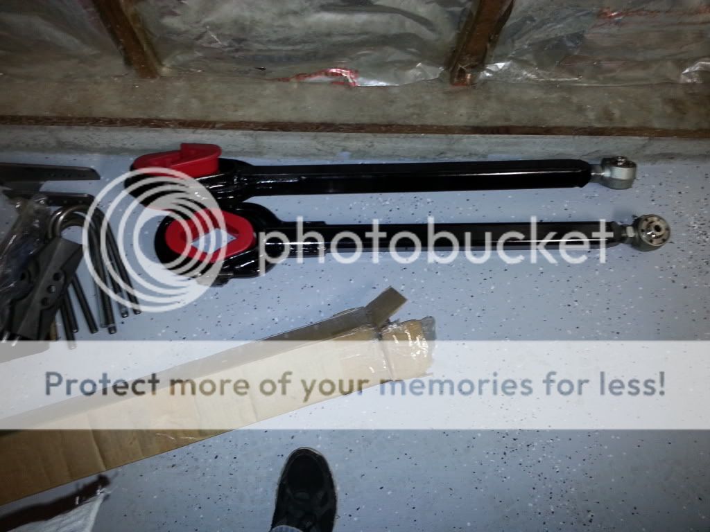

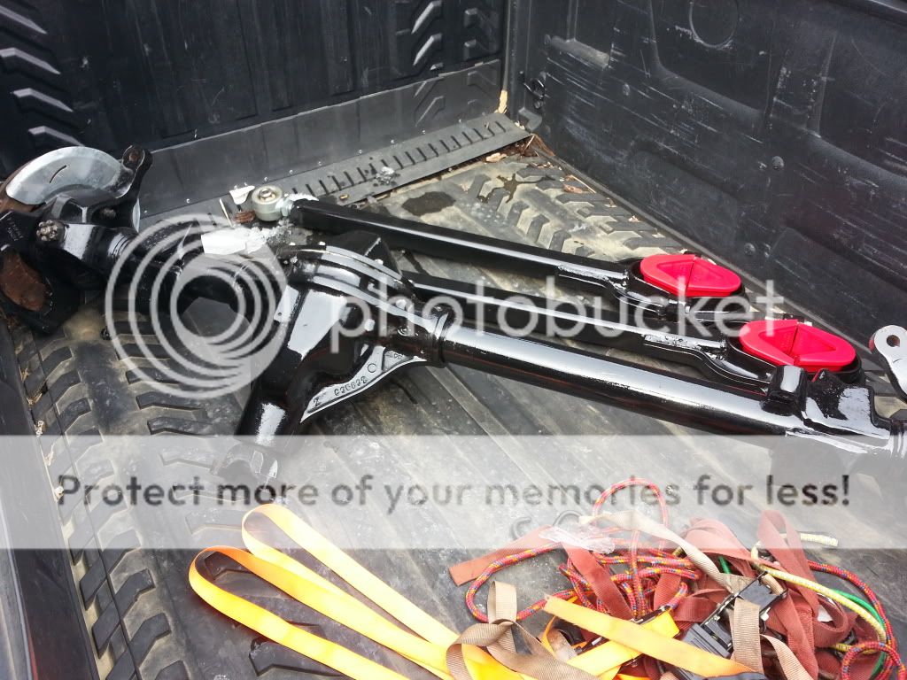

Well I bought another d44 FI but this time it's been completely rebuilt already. It has 4.09 gears and a limited slip. I plan on swapping out to 4.88s and leave the l/s for now. I also got some 36" radius arms with heims, ruff stuff 1 ton gm tie rod steering kit with dom tubing, ruff stuff track bar kit, and 8.8 axle swap kit. I'll hopefully be picking up some 63" Chevy leaves and a FW 8.8 at the junkyard this weekend. I still need front coils, brakes calipers for the front, and brake lines, and I need to figure something out with the coil buckets. What's the best and most affordable route for a good coil bucket that won't make the coils bow? I'm gonna be running 35s, can anyone suggest a coil spring that flexes good and will clear 35s? I was looking at the wild horse 4th EB springs but don't know if I should get 5.5" or 4.5". Anyway here's some pics.
ive heard duff coils are good and flexy and the wild horse are good but stiff road manners (all hear say)
Good pickup. My 8" skyjacker TJ springs are great offroad but too soft on the street.
Nice build, you should hit up turkey bay on a weekend. 190-250 ppi is what your looking for. XJ coils work great, no mods. Im using rough country XJ 190 coils on a truck I'm building now...

Svt, if I use the X coils and stock coil buckets on the frame side will my coils bow out since the d44 is wider? I saw some heavy duty coil retainers for the radius arm side on James Duff that I thought said can move the radius arms spring perch inward. Does that sound right? Or is it necessary?
