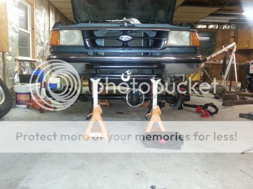

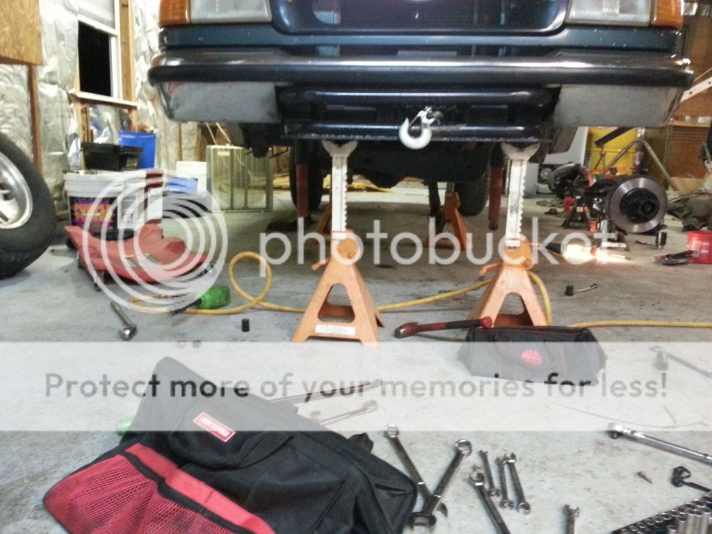

I finally started my sas last night. Got the old junk out and the new axle is just sitting under there on jack stands. Gonna knock the rivets off the coil buckets tomorrow and hopefully get the radius arms mounted on the frame and get the new coil bucket location figurer out. So does everyone usually move the axle about 1" forward? Also what pitman arm dies everyone use? I have the GM 1 ton tie rod kit from ruff stuff to make my own steering but I think my drop pitman arm is gonna be too low.
Here's a few pics.
btw it's getting a FW d44 with 4.88s (open diff for now), FW 8.8 4.88s (open diff for now), 63" Chevy springs, extended arms with Johnny joints, and a manual shift t-case
When I did SVT I pushed it forward 6", I'd recommend going 2-4", using the 6" drop pitman. If you're gonna stay low or high steer, might want to try either the stock pitman or a superduty pitman....

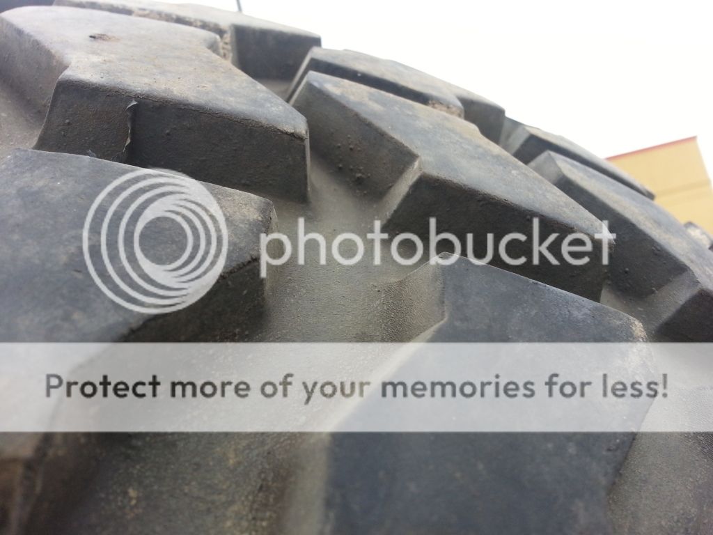

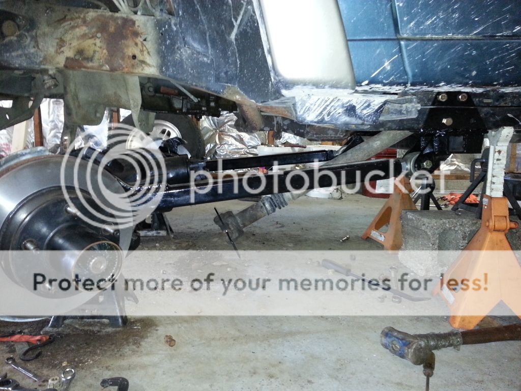

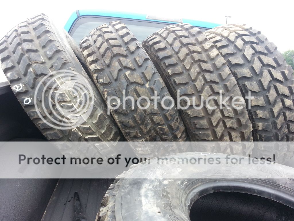

Yea, I've made the new transmission cross member and radius arm mounts, bought some James duff coil buckets and track bar mount and got them on. I've redrilled the James Duff lower coil mounts buy still need to put them on and get the coils in, make my steering and track bar. I have all the parts, just gotta find motivation. I also bought some 37x12.50x16.5 military tires off a hummer. T hey're like % 90 tread and got 5 of them for $600 so I couldn't pass them up. I know they're not ideal but they'll work for now.
Here's the x-member

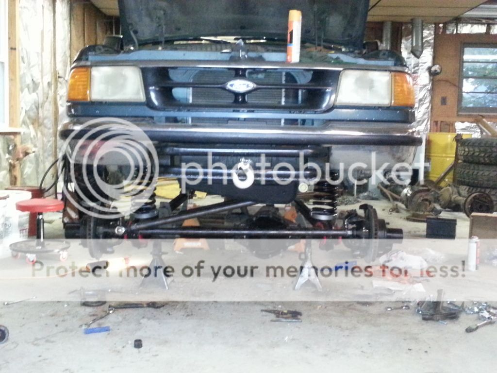

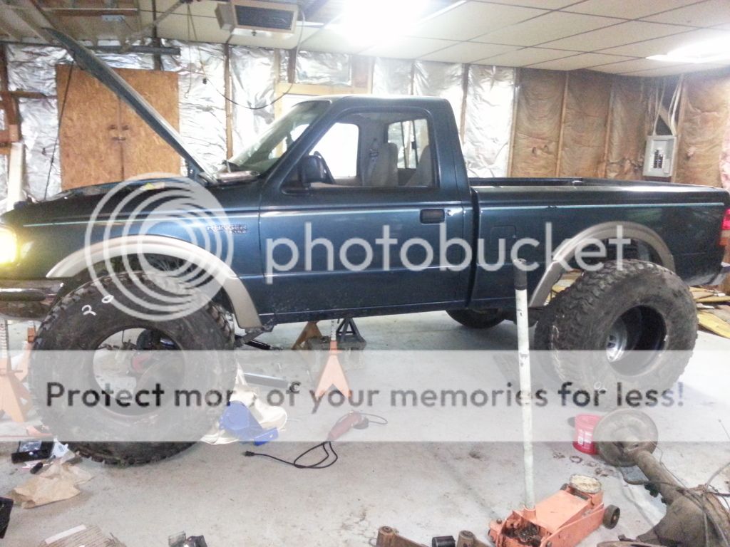

Well got the steering and trac bar done and the front of the truck on its own weight. Still gotta tighten everything up, paint the steering and trac bar, put the hubs and brakes on it. Wheels should be here early this week so I can get the front end done then move on to the rear.
Oh and the trac bar and drag link are the same angle and are within 1.5" of the same length so hopefully that will mean no bumpsteer.
