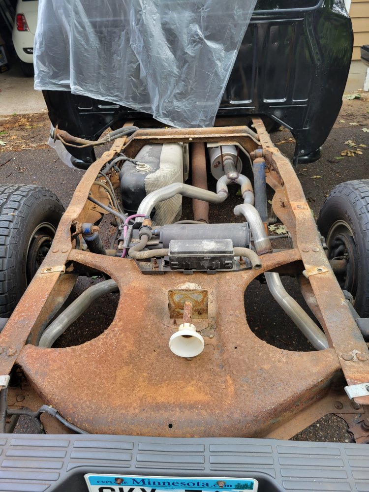

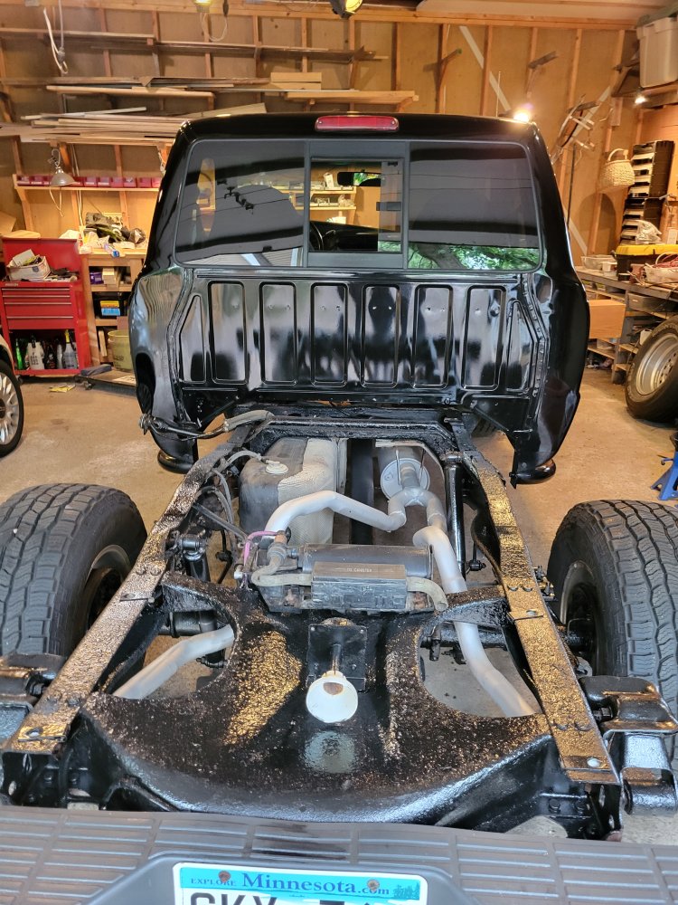

I found my frame rusty but well worth saving. That's why I bought it. This is not the case for many other 20 year old Rangers up here in the snow belt. I sand blasted/media blasted it. The blaster removed the crusty rust (and will find trouble spots). A cheap blaster cost about $80. Then I repainted it with POR 15.

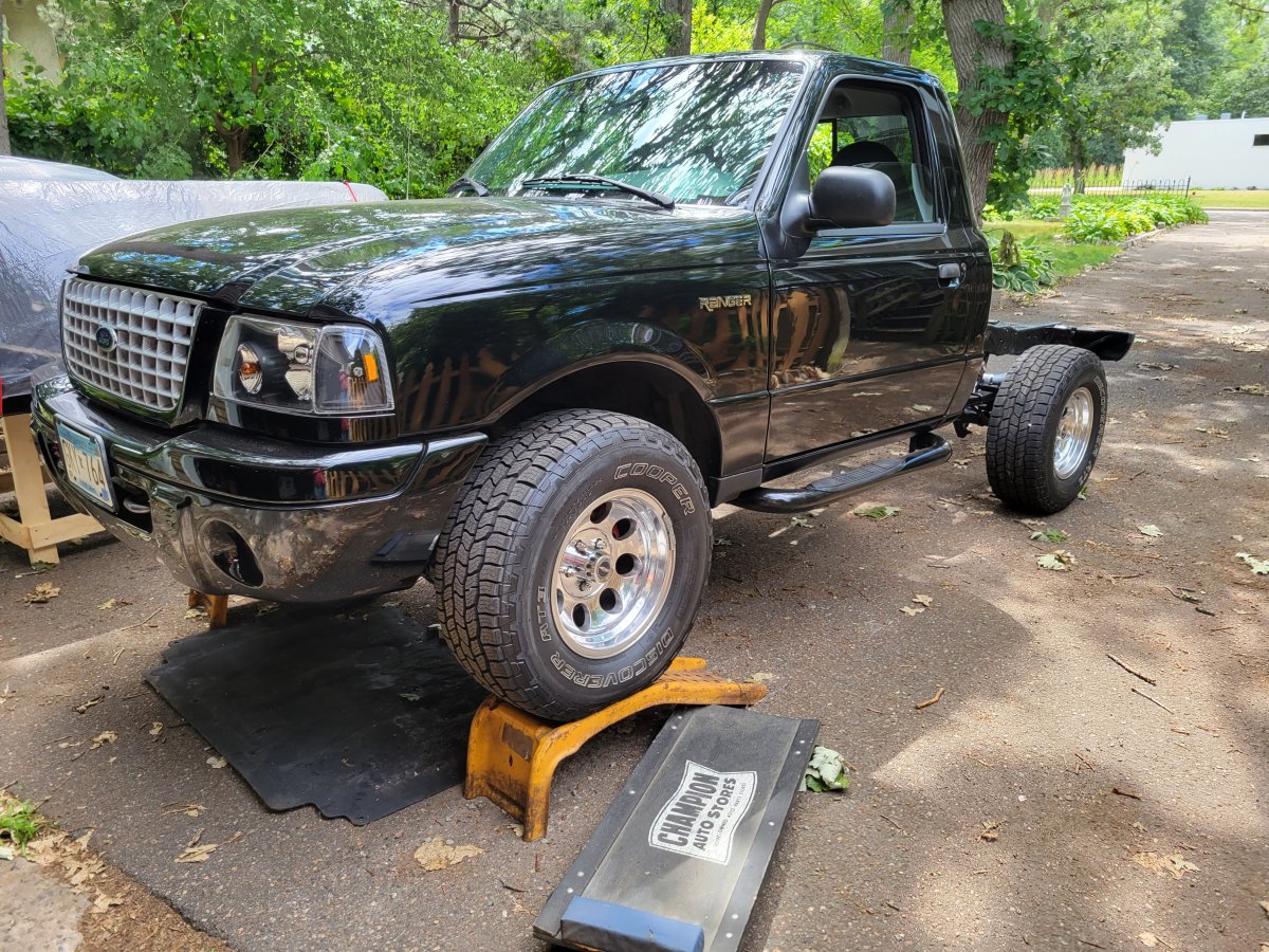

I painted the frame under the front half too. Putting it up on ramps was all it took.

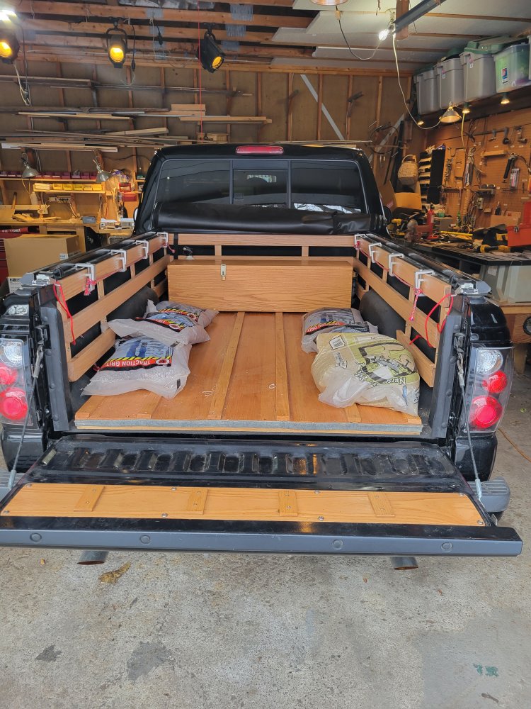

The bed floor was badly rusted and showing holes. I sealed it with POR 15 and covered the holes with a homemade oak bedliner.
My friend has a Ranger with a badly rusted frame. We intend to take the bed off, sand blast it, and bolster it this summer. And yes, the worst always the back half.
I found it's easy to restore a Ranger. Cheap plentiful parts at the U Pullyard make the job worth it too, even if it is far gone. Trust me. I'm no mechanic. My friend and I have already discussed buying a third Ranger and fixing it up, just for fun.

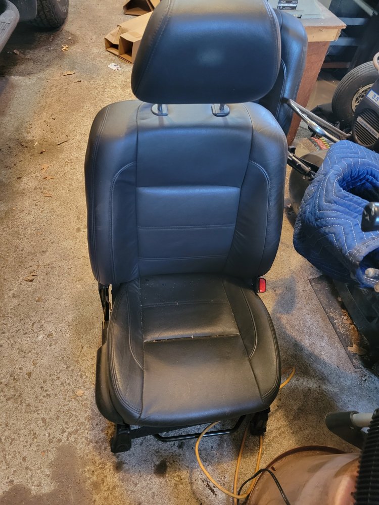

Cars and trucks have two different and distinct lives. The first is when you buy one. Everything is shiny and clean. The trouble is that the joy of ownership steadily fades sometimes even disappears long before you make the last monthly payment. The second begins after that: when you notice you have a few extra dollars in your pocket at the end of every month. Of course you have to keep on with repairs, repainting, and replacing, rebuilding one part a time. This second life, however, is where the fun can begin. You can do more than restore. You can use some of your extra money to upgrade, modify, customize, and make it new all over again, this time a machine that becomes unique, all your own.
For example, I just bought two black leather bucket seats. They are from a car. They look brand new. I can't wait to put them in.

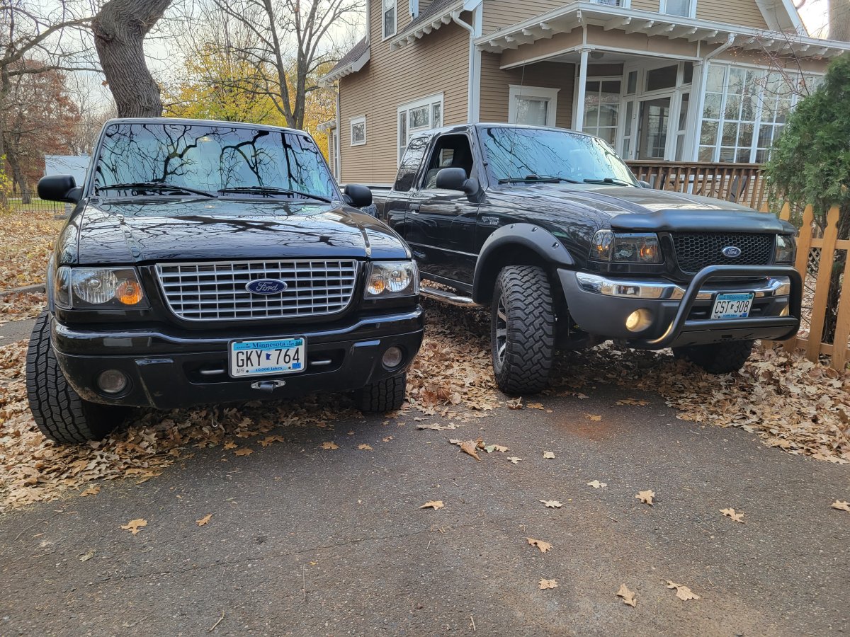

Very well stated. There is a certain math at work there. But numbers can be terribly deceptive.
There is a time in a car's age, call it the Terrible Twenty, when it approaches 125, 000 to 175, 000 miles, when it seems everything seems to break or need to be replaced. Most, many, sell their vehicles long before that, of course. But the few who make it to 125,000 often get discouraged repairing or replacing so much, and in such a short time. The junkyards are full of Ford Rangers just like this. I have found that it is well worth it to go counter trend, that if you are patient and proactive, you will get through this phase and be good for another 125,000.
This is another reason why I believe in paint and body work. I'm willing to bet that dents and rust add up over time, and also take a toll on the owner's mind. They look at that aging body and think that their vehicle is not worth it, that they just want to start all over with a new car again.
I think a paint job lasts for maybe 11-15 years. Paint and body need to be factored in. Take a minute and look at this thread, Rattlecan Ranger Restoration https://www.therangerstation.com/forums/index.php?threads/rattlecan-ranger-reclamation.198533/
It is a story about a rusty old Ranger XLT. My friend paid $2,000 for it, only to have it burn up in a garage fire. He could have totalled it out, but we decided to save it instead. We repainted it with Rustoleum one panel at a time. The Rustoleum rattle can ranger is the one on the right.
