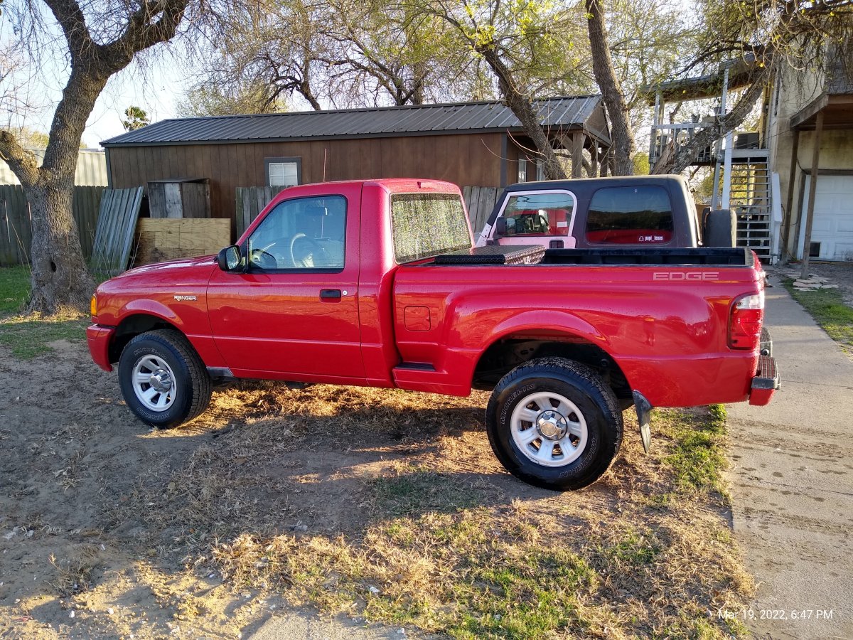

I like the look of the stepside, it's what I have too, but as far as useful, the straight bed would be way more useful for me but finding one the right color hasn't worked out yet.
If you are going to use it for truck stuff and maybe put a toolbox on it, see if you can find a straight bed.

Personally, id look for a junkyard bed. If youre not partial to the stepside a dime a dozen shortbox will interchange.
Thanks. So I should go for a short bed to replace the flareside. I assume the longer 7' bed won't fit, only the 6' bed - is that correct?
I believe so. I think the longer bed is longer between the cab and wheels
Plus the 7ft bed would hang off the frame in back :)
Yes the 6ft bed should almost directly interchange with the flareside. I think youll need a filler neck though from the regular bed IIRC.
Yours is a 94 correct? Any bed from 93-2011 will work in the proper size. Just the taillights and tailgate styling are a bit different.
Yes, the Long Bed box and frame has the rear wheels 6" farther back, so if you were to put long bed box on regular frame and lined it up with wheels there would be a 6" gap between cab and bed and it would stick out 12" past the regular frame

You can't line up a 7' box on wheels without cutting 6" out of the cab to allow the box to fit that far forward :dntknw: If you try to fit a 7' box starting with front box bolts, you will find the cross member don't line up for all subsequent locations, the front of the wheel wheels sits on the tires, and the box extends a foot (1') past the end of the frame i.e. nothing but air for rear bolts to bolt to. A 6' box on a long box frame , when lined up with wheel wells, leave 6" gap between box and cab, and the tailgate flange sits on the extended frame rails. (Which I think @RonD was referring to).
Up to '98, the frames were all 1 piece: You had a regular cab/short bed, regular cab/long bed or SuperCab/short bed. And there are 2 and 4wd versions of all 3 frames due to different frame cross members at engine* As the OP is pre '98 he would be looking at whole frame replacement (per Ford).**​
98+ frames are 2 piece: There are 6 front sections: regular cab for short bed, regular cab for long bed, SuperCab (only works with short bed) lengths with coil spring (2wd only) and torsion bar (Edge 2wd and 4wds) options for each and 2 rear sections - short box and long box. So, if just back is damaged e.g. accident/rust, it can be replaced.​
Note: The front sections extend ~16" beyond back of cab for both Regular cab short box and SuperCab , while the Regular Cab long box front section extends ~22" beyond back of cab to the split point. The rear sections are identical from split point to rear spring shack mount, after which the long box is 6" longer. Ford attempted to prevent us from making SuperCab long box using OEM parts.​
The 6ft styleside bed directly interchanges with the flareside. You'll need a filler neck though from the appropriate bed, matching tailgate and bumper. (Bumper is aesthetic, not functional) You would want to keep the wiring/tail lights from original bed. There are subtle differences between years i.e. 2 bulb versus 3.​
Exceptions (this is Ford, there are always exceptions):​
Swapping 83-92 boxes of correct length onto '93-11 frames or vice versus is entirely possible, but the panel lines, primarily wheel well shape, isn't correct. It's an aesthetic thing, not functional.​
98+ Mazda boxes do not swap onto post '00 frames as the tail lights are 3 bulb, while '01+ Rangers are 2 bulb. (STX Ranger might have correct tail lights; I've not had one to check.) Ranger boxes swap onto '98+ Mazda frames if you get '93-'00 Ranger tail lights.​
