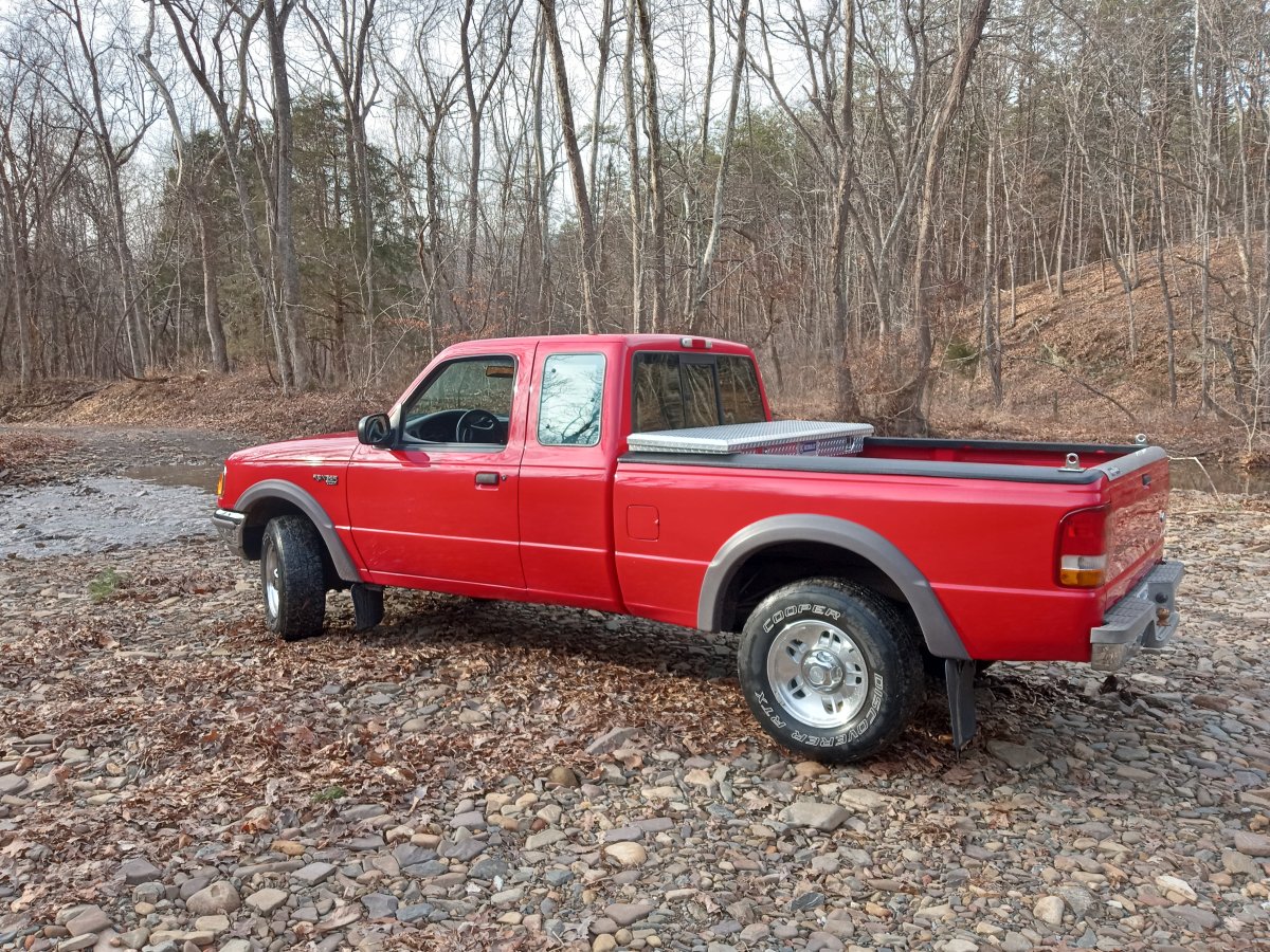

Seems like my '97 paint is lasting more than 15 years (26 years old). Hand glazing / waxing will improve it yet a bit more.
Can't wait to get the oem size 31" (or 265's) on it (has 235's now), it'll look better and gain a bit of clearance. Took off ugly rusted ball hitch since this pic.
Truck is totally stock, everything works, has power everything and buckets, interior is like new. No rear doors, kind of a bummer, tool box makes up for it somewhat, but I just tell myself, one less thing to break, and couldn't get them anyway that year. The only thing not original, besides tires, is it had pinstripes, but I'm tempted to leave them off, you have to wash/wax around or over them, seems like it's probably not worth it. Truck is sure footed, tons of power. Newer truck would have not much over it - lockers, and more tow capacity, so might upgrade someday, but I could sink a ton into this truck in upgrades (or fixes) before I'd even approach the price of a new (2019 up) gen truck. Already have had more fun in this truck than any vehicle I ever owned regardless of cost. Most pressing thing right now is check diff's/xfr case levels, and hook up higher vent tubes for them, I'm in water a lot when 4x4. And the tires. I need to do those things, just have been enjoying having a vehicle you can get in, it starts, drives nice, looks decent, and has no broken stuff on it. I'm just thinking I want to be looking for things that could stop me out in the woods where it's a whole different situation than being broke down in town. So it's possible there could be something I missed but even if that's true and I had to sink some money/work into it, it's worth it as my feeling is they put these together right. Possibility that some replacement parts could be hard to find is a potential minus.
