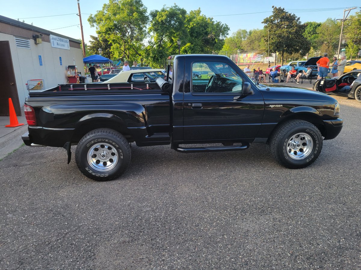

Thanks for the mention. Yes. I bought an 18 year old Ranger and restored it to new. It may sound crazy, but @Blmpkn is right. No one makes a body style like that anymore. Today's trucks are all cab and no bed, hard to park too. The new ones are lifted or raised, making them difficult to load and unload.
I suppose I could have bought one anyway. I got the money. Hell, I could walk right into a show room and write a check.
I chose to restore instead: bought a Ranger for $4,000, took the bed off the back, sandblasted, repainted the frame and the underside. spent $13,000 at the body shop fixing the rusted body and having it repainted, bought new wheels and tires ($600), installed twin exhausts ($500). I did some work under the hood, replaced hoses, battery, alternator, ignition, spark plug wires, seafoamed everything twice in two years.
Now I got the truck I want. It runs like new, and all for less than $20,000. It's got 150,000 miles on it. It's good for maybe another 100,000. And if not I'll put a new engine in it. That little Ranger would still a good deal, half the price of new.
That's a good looking truck dude
Thank you! Basically it's brand new. New wheels and tires and clean glass are very cost effective ways of making your rig look good. I replaced the glass when they painted it. But you don't have to replace. Just a clay bar and buff freshens it up.
