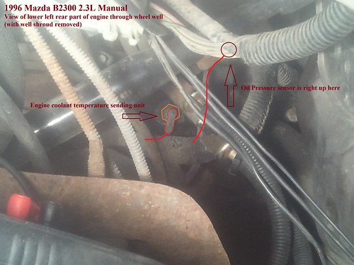

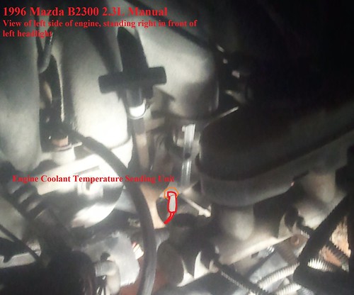

-Also found the Temperature sending unit (in the photos). Grounded that out and the gauge didn't move.
