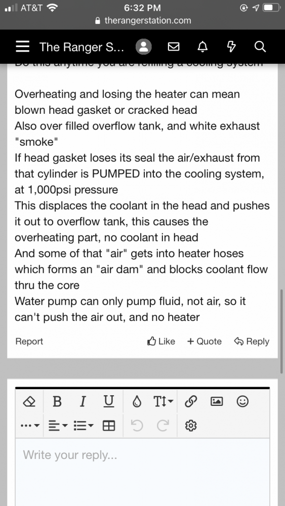

well, on my way home a couple nights ago my temp gauge started reading on the middle to higher side of normal, while still blowing cold air, so I knew something funny was going on aside from the clogged heater core. Got home and looked under the hood to see coolant had sprayed from the radiator cap and the overflow was nearly to the brim. Cant be a great sign, right? Lol. This was the same day I burped the cooling system.
I checked the oil this morning and it is surprisingly not milky.

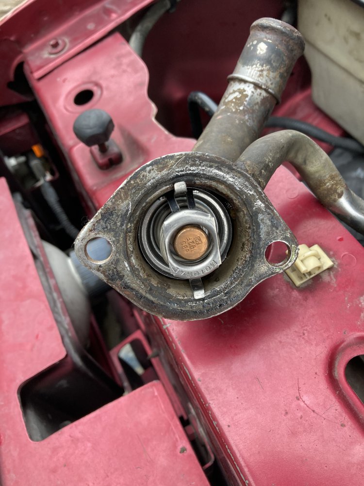

and yes I believe I put the thermostat in correctly but I was thinking about taking the housing apart again to do another flush without the thermostat, I will make sure then.

i know the housing doesn’t look great but I did happen to snap a picture of the thermostat before I put it all back together
Welp doesn't even look like ya could put it in backwards been awhile since I changed mine. Alright then. Solves that.
