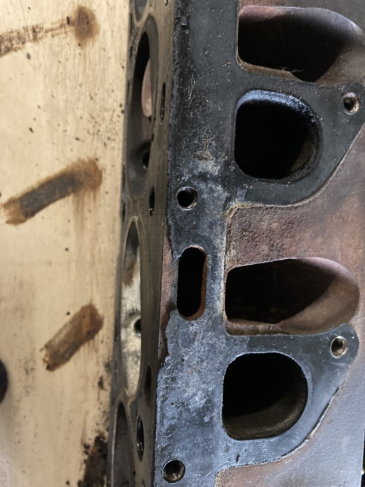

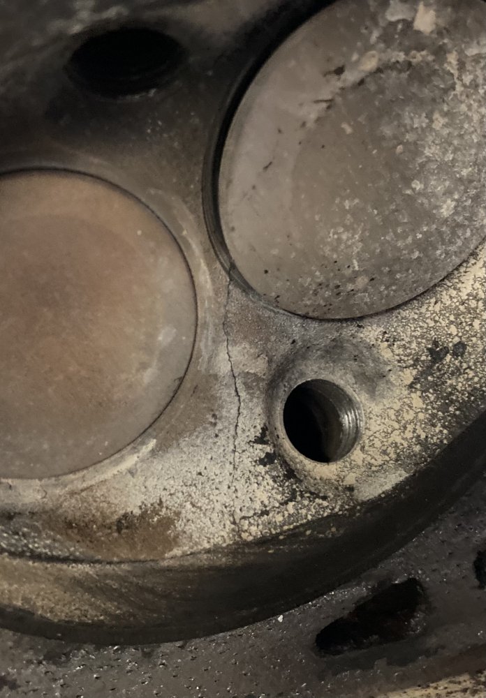

Well, I’ve finally got some results. The head gasket isn’t blown but I’ve got a crack. And gasket for lower intake manifold is busted
  • 94 ranger, reading cold and rough idle

Looks like the crack in the head is big enough to cause the issue, but small enough to not muck up the oil.
