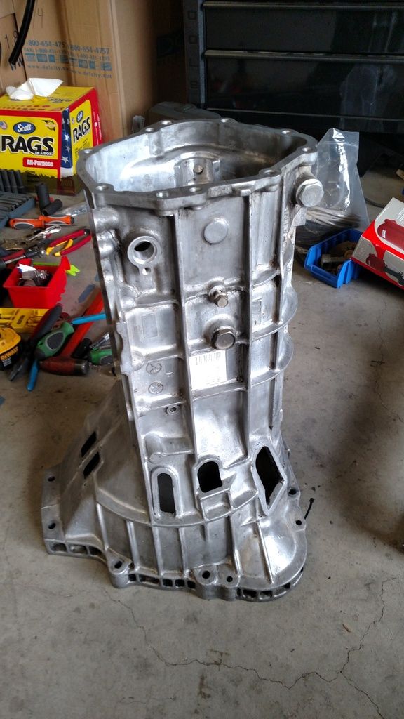

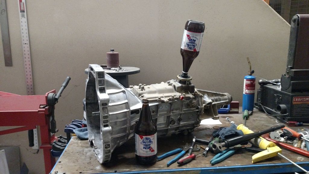

Almost ready to do the 2.3/4.0 hybrid. 1 step closer to firing it up and driving it! Can't wait!
Success!!!! One 2.3/4.0 hybrid M5od!! Actually went really well, just took my time and it went together smoothly.
Transmission is nice and clean. Looks good man.

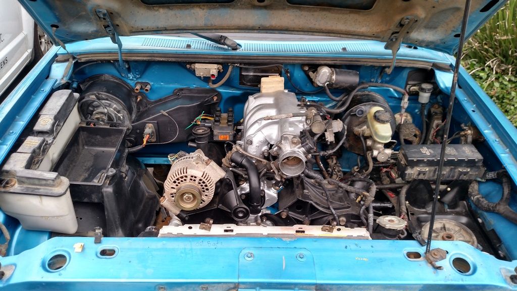

Harnesses all ran, waiting on the clutch and flywheel, so close to firing it up and driving it. Hopefully by next weekend.
Got my clutch and flywheel in. Also went to pick n pull this weekend, scored on a throttle cable and vacuum harness. There was a damn near New dash, hopefully it will be there this weekend so I can pick it up.
Got the clutch, flywheel, trans and driveshaft back in. Just a bunch of odds and ends and I should be able to fire it up today or tomorrow and take it for a short Cruz. Waiting on the cat, so I will be running a test pipe until then.:headbang:
Might be a dumb question, but i didn't pull off the Y-pipe when I got the engine, is there exhaust gaskets between the manifolds and the Y-pipe?
Nope. The Y-pipe ends are flared and they fit over the end of the manifolds which have a matching radius. :icon_thumby:
