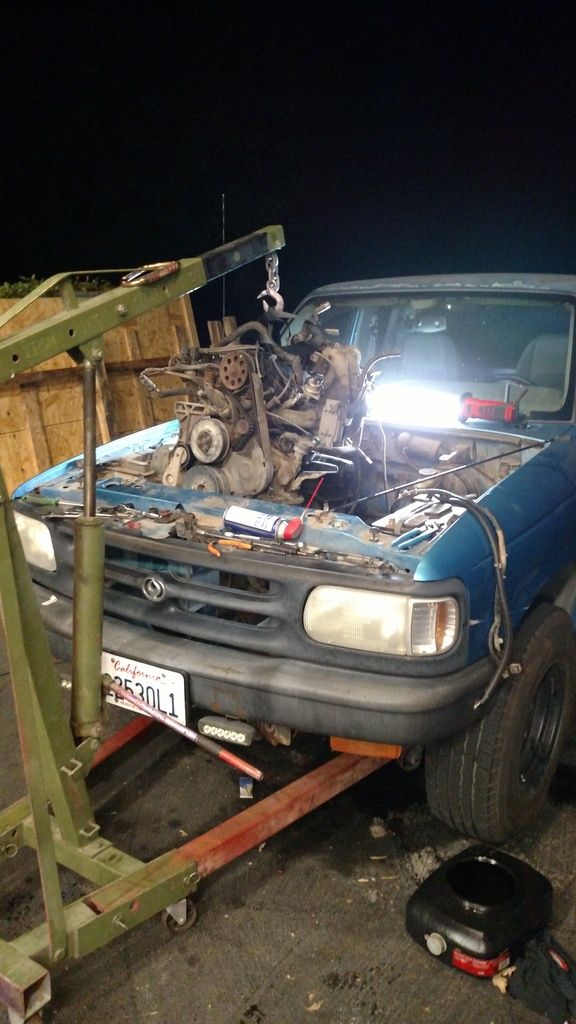

Well its finally at my shop!!! Going under the knife right after work!!! Excited to finally get going on the swap, really tired of the gutless 4 banger:nono: I'll post some progress pictures tonight. :yahoo::headbang::beer::icon_welder:
Didn't go to bad, able to pull the tranny and engine tonight. Will be cleaning the engine bay tomorrow.
More to follow tomorrow.

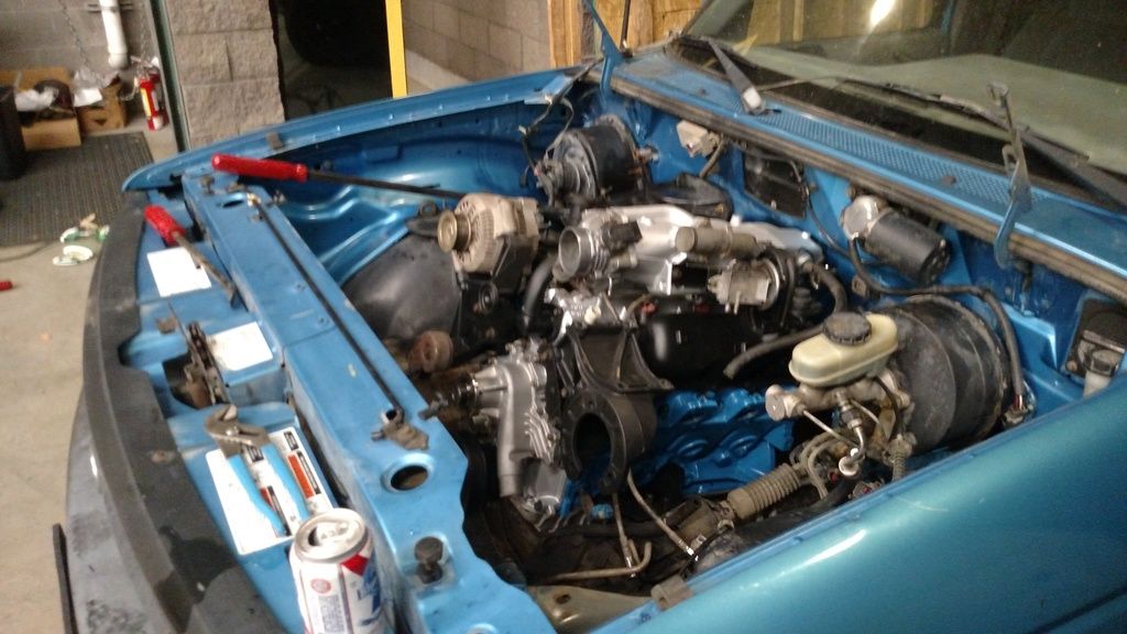

Going to clean up the engine bay today after work, I need some opinions on whether to paint the bay flat black or keep it blue. What do you guys think?
I say paint it black. When I had my 3.0 rebuilt earlier this year. I looked at my engine compartment and it needed a paint job. I painted my whole engine bay semi gloss black. Looks alot better. Looking forward to your progress and the final assembly on this. You should leave the b2300 fender emblems on there. Make it seem different from what others will think what's in there.
Did you get the mass air flow sensor and top air filter lid when you bought the 4.0? The 2.3 sensor and air box lid is different then the 4.0.
painting it is what i'm leaning towards, once i get it cleaned up i will think about it more. I planned on keeping the b2300 emblems, about the only chrome on it and it just the right amount.
And yes, i got the MAF and airbox with intake tube from the donor. Guy was really cool, he's into rangers and after we got to talking, he said i can have whatever i want from what was left of the ranger.
Think I might just leave it and not paint it. What do you guys think?
Edit: added a better picture.
Got it dropped in and bolted to the motor mounts!!
I'm pumped!! Now onto the trans!
That engine bay cleaned up nicely. Looks like everything is going well. [emoji106]
