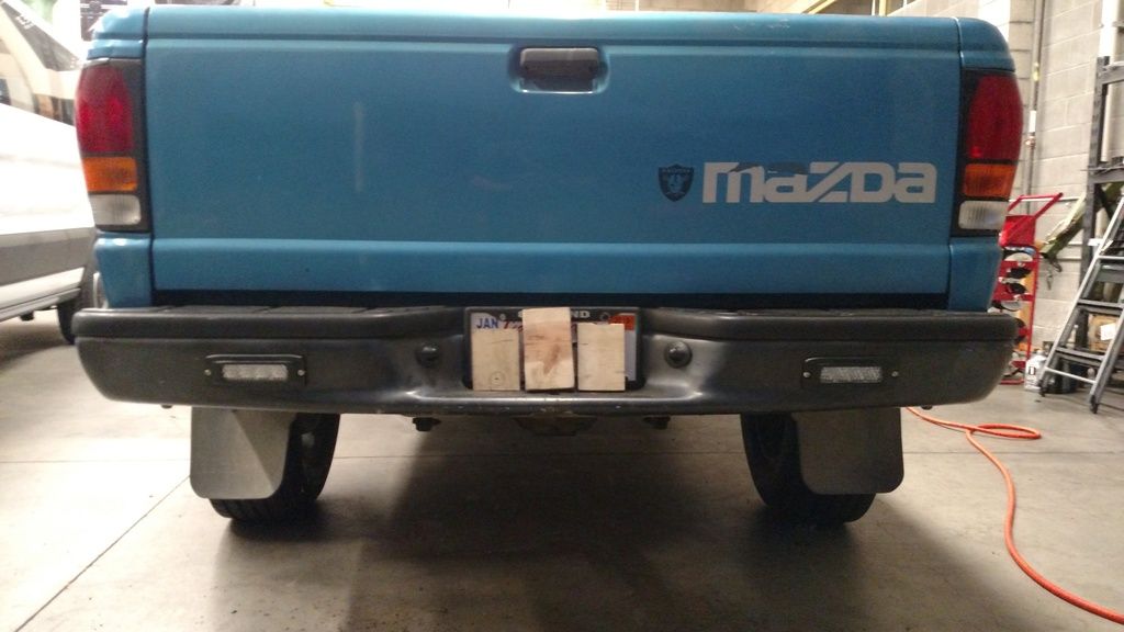

Since I'm waiting on my coil pack, I decided to install a set of Ridgid back up lights into my bumper. I just mounted them and decided to call it a day. will wire them up tomorrow, as long as the coil fixes my problem.
