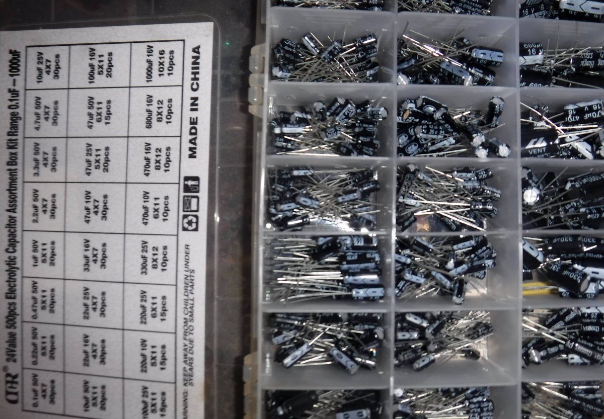

I got my stuff to fix an old TV, but it's the same stuff. I know them as transistors, I don't know what they call them now, I got a lifetime supply off ebay for about 10 bux.
And I got a 30W (You DO want the 30W) iron from ,actually I believe it came from home depot, for about 20, with all the bells and whistles, it wasn't difficult at all to do, the TV anyway. But when my computer goes down I'm all set to go
