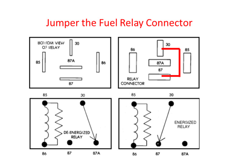

Don't be intimidated, your relay should have a diagram on the side. I just use a paperclip. Here is an example. From Google

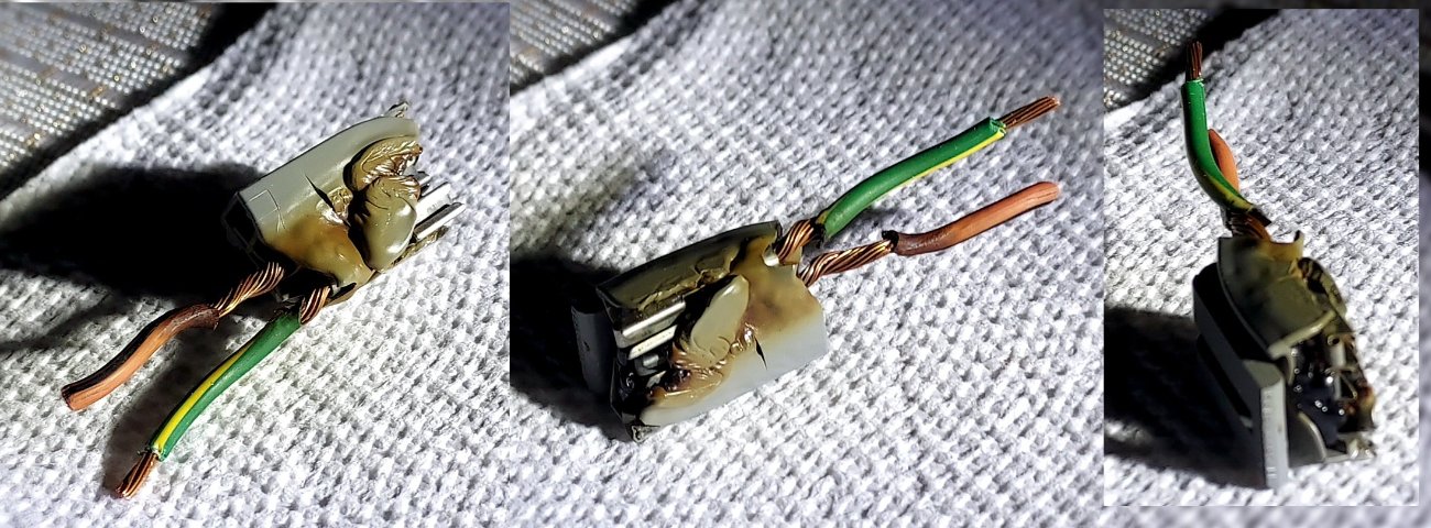

Not in my case. Apparently, the wires to the Fuel Pump Inertia Switch (FPIS) would lose contact but would reconnect after a period of cooling or the monitoring that the Powertrain Control Module (PCM) does of that circuit was disabling the fuel pump relay. Here is a link to what my problem was. https://www.therangerstation.com/fo...-pump-inertia-switch-fpis.216147/post-2129897
