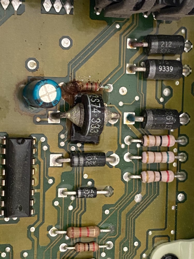

Well i Finally got the time to get the computer fully out and opened it up and these are the spots that ive found. How would i go about fixing this?

If you solder or have a friend that does its pretty easy to replace these
An electronics repair shop can also do it for you, they will usually have the correct capacitors "in stock"
Take lots of pictures so you can see location of each capacitor and its Value, i.e. 16uF 50v(volts)
Also each capacitor will have a stripe on the side denoting negative side, its important
These are called radial capacitors
Get the 3 replacements, under $5, but some times you have to buy 5 at a time because they are so cheap its not worth selling them one at a time, lol
You have to match uF exactly
But you can use a higher voltage, i.e. if it shows 16v then you can use 25v, 50v or 100v as long as uF matches
Do not use lower voltage
The circuit board has a spray on coating to protect it, on both sides, just FYI
A "solder sucker" is a good tool to use to remove the old solder so you have an open hole to install the new capacitors
After old ones are removed clean the area as best you can
90% or higher Isopropyl alcohol is great for cleaning electronics
Lower percentage has water in it so leaves a residue
Install the new ones making sure to match the Negative stripe orientaion and uF/voltage values to each location
I did this a few years back and my 1994 runs much much better
FYI that capacitor goo is corrosive. So even if you replace them, there is a chance that the traces on the circuit board are damaged as well. You want to do a continuity test on ANY trace that has been touched by that... your second picture looks terrible. It is possible to fix traces by soldering on bypass wires but if you've got several it's probably easier to buy a reman ECM than spend hours fixing yours.
PCB (printed circuit board) repair kits used to be available, which consists of strips of heat-setting trace material, and the foil collars for the pass-throughs (holes). There also used be the green conform coating, in applicator pens, to reseal the PB after a repair.
Changing those caps, and repairing the PB if needed, ain't that bad if you've got the tools, and patience. A reman ECM, or a shop or somebody with the tools and know-how, may be a better option for most people.
Well after some consideration I took it to a computer guy I know that can solder and he looked it over and said that the board was too far gone near the capacitors for him to repair it, he also noticed on the back side of the board had some significant water damage and was surprised that the truck even started let alone run. Looks like I'm back to buying a new pcm sadly. I'm not giving up on this dam truck though lol
