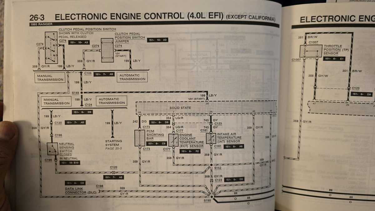

I can share electrical diagrams and a few ideas later this evening.

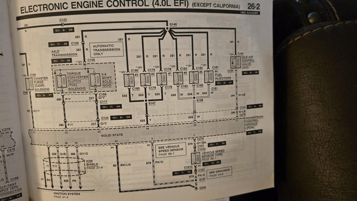

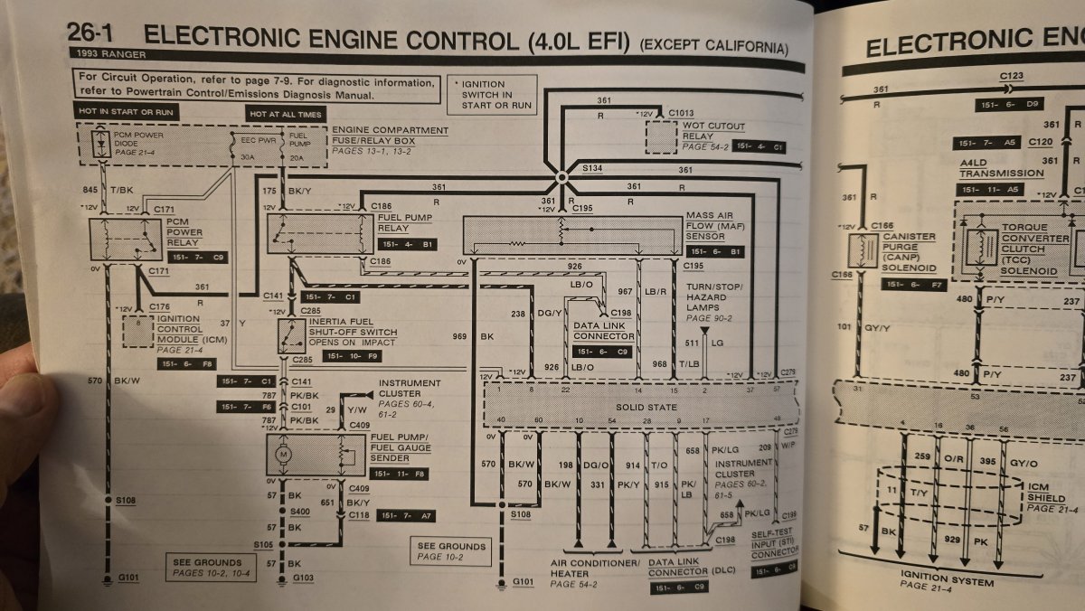

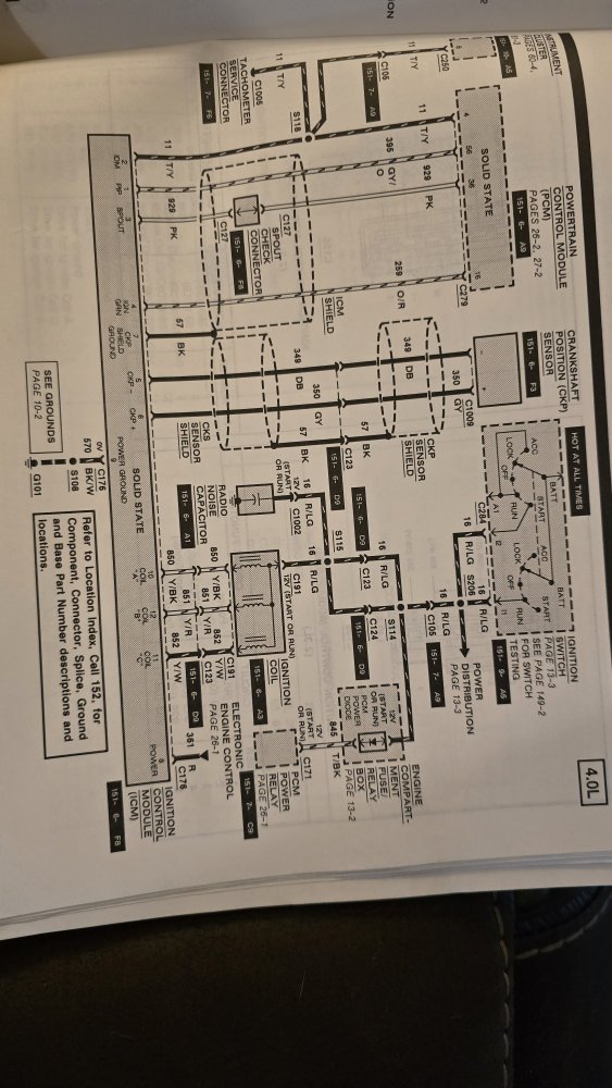

Ok. Attached are some electrical diagrams that may be pertinent. The first one, page 21-4 is probably the most important.
It seems you don't have spark. So, we need to see if you have voltage to the coil with the key turned on. That is the red wire with light green stripe at the ignition coil. We also need to verify power to the pcm power relay in the engine compartment fuse/relay box. More info at the left side of page 26-1. And we need to verify 12 volts (with key on) on the red wire at the ignition control module. That module is mounted on the radiator support just inboard of the driver side headlight. Also check your ground connections on the radiator support near the driver side headlight.

look careful at the pcm grounds at the battery.... that code is odd if the pump is strokinh
So would you think it is a wiring issue or what

Starting to look like a loose ground connection somewhere.
