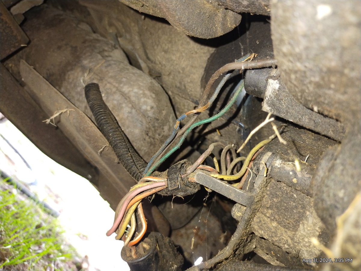

How do I check the ground and relay I have a multimeter but I'm not experienced in operating it I can learn quickly but not to many videos demonstrating how to use it to test sensor and ground in vehicles

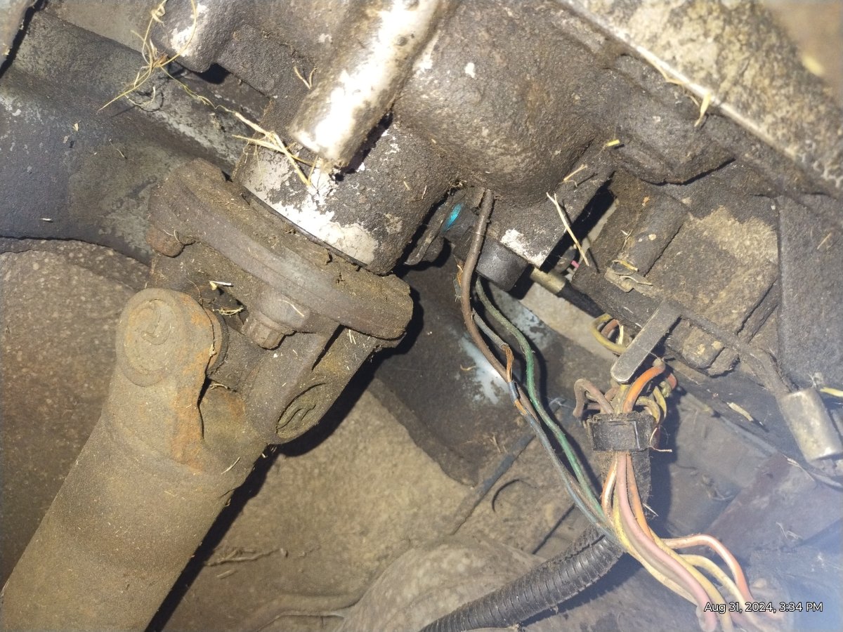

Does anyone know what that blue wire is going to and if that would cause my crank no start the blue wire next to the green.
Update the codes it is currently giving me is 556 and the recent 159.
Is this a 4 wheel drive? Not sure the color of the wires> Are they solid brown, blue and green or do they have stripes of white?
I'm not really sure what area of the vehicle this pic is showing. I think it is of the transfer case. If that is correct, then I don't think this would cause a "no start" issue. If I am wrong, others will be sure to let us know.

566(O) transmission 3/4 shift solenoid/circuit – Transmissions
629(O,M) Torque Converter Clutch circuit fault – Transmissions
Shot in the dark here , but those two codes you posted earlier in this string could be related to this wiring issue....
Where was the vehicle parked?
I admire your fortitude. The mice had a great time.. o_O

the trans codes are why i suspect the factory hammer solder branch may have overheated and failed and the computer is not seeing power on the solo side of the trans and no power to the injectors will also cause a no start.
thing is that should have popped a fuse. so back to rats chewing it up.
verify power to proper side of injector. verify continuity from ground side of injector to pin 58 and 59. verify power to transmission.
