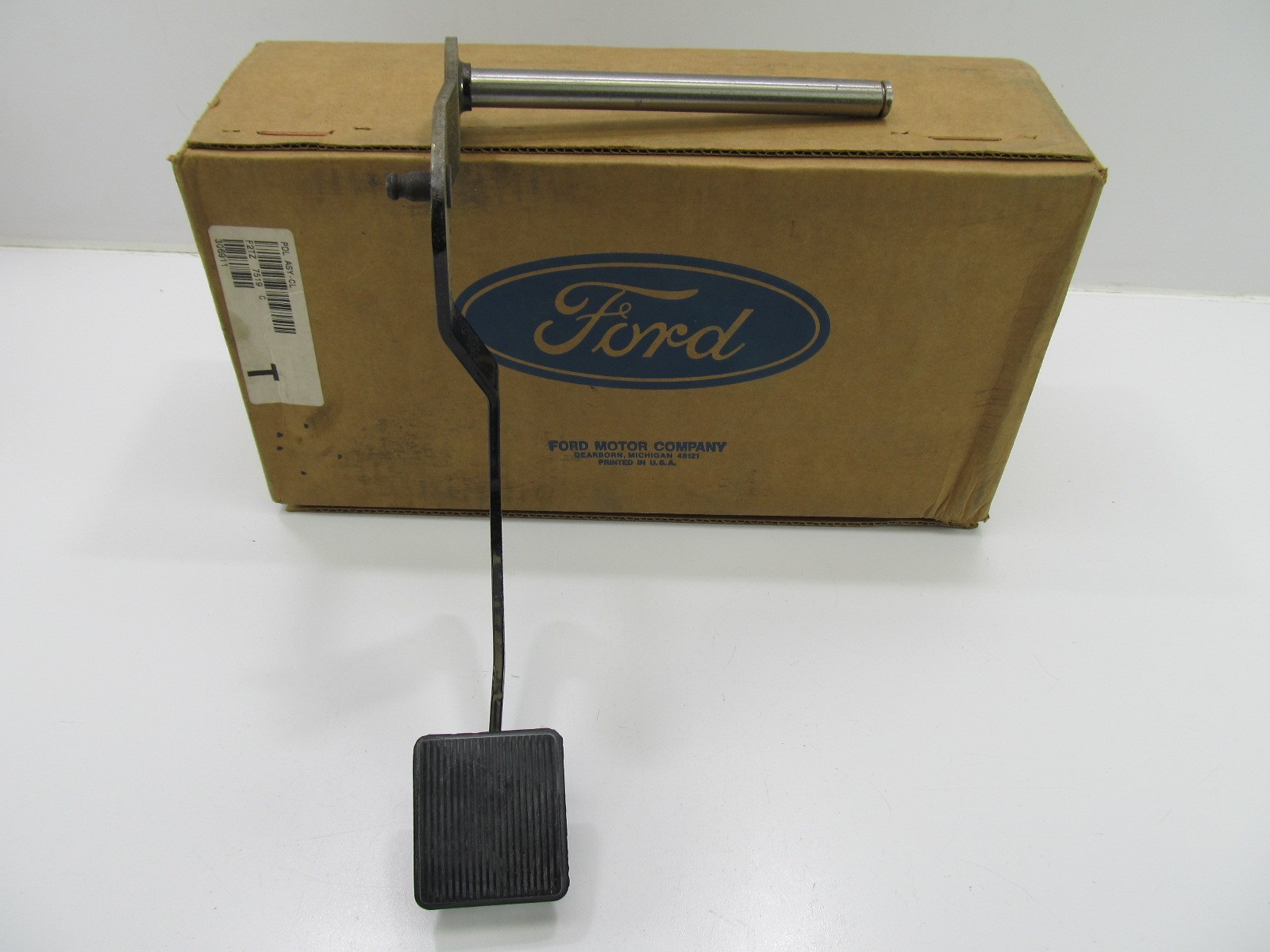

So... Looks like finding a clutch pedal is going to be problematic. I think I saw a photo of what I'm looking for.
Is the shaft is attached to the clutch pedal and shaft goes into the bracket and through the brake pedal bushing? oops on the photo size sorry :(
Like this?
Your automatic brake pedal is larger then the ones in the 5spd rangers. It will be easier to get a clutch / brake assembly from a 93 / 94 ranger at the junkyard.
That is true but it's also very easy to change that with a cut off wheel But I can't find any locally (yet)
