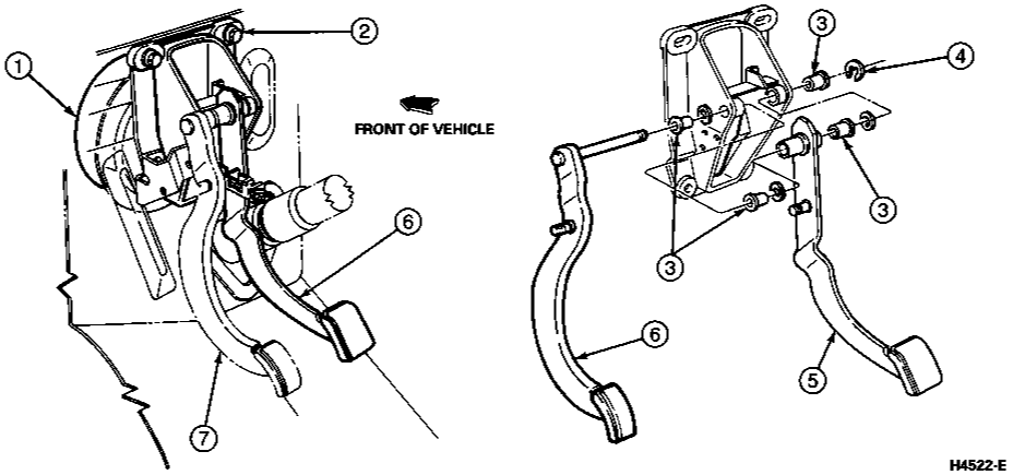

That diagram looks more like the clutch/brake assembly on my '96, but I'm trying to fix a 2003. Do you think the same clip will work on both?
what, no thank you? lol :headbang:
This one is listed years 95 - 11 same one comes up on to 2011

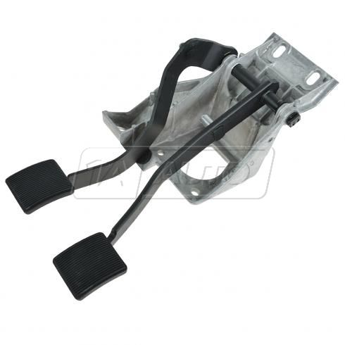

I've googled several images of the assembly and found both of the images you've shared, but I've had trouble getting a "close up" of the particular black retainer clip on the right side there. The other issue is finding a replacement because I don't know the part # or the name of the part.
