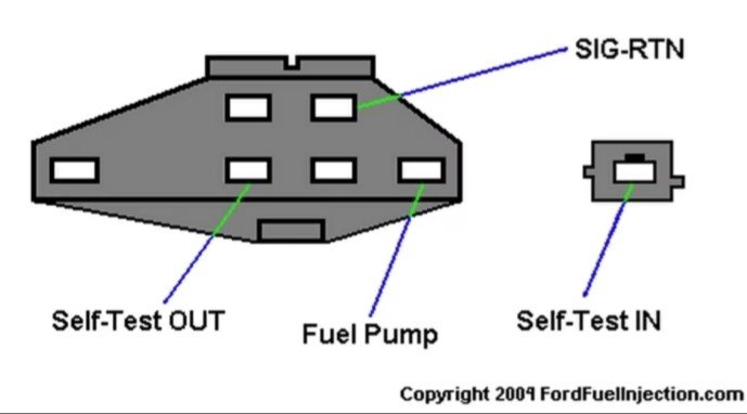

There is one wire on your ECM/OBD test connector that you can ground out and it'll make the fuel pump run all the time. I would do that and see if it'll start and run then. If it does then I would suspect there is an issue in the ignition/fuel pump relay/ECM wiring somewhere.
Great to know! I’ll try that out and report back. Im getting a bit caught up today so I might have to give these all a shot tomorrow.
I was content with the sputtering because I wasn’t getting anything without the shot of starter fluid. I then checked to make sure the timing belt and marks were good before moving on to check more fuel related issues. But the wrench to start solenoid and the continuous fuel pump ground seems like it’d give me a better idea on where everything stands.
